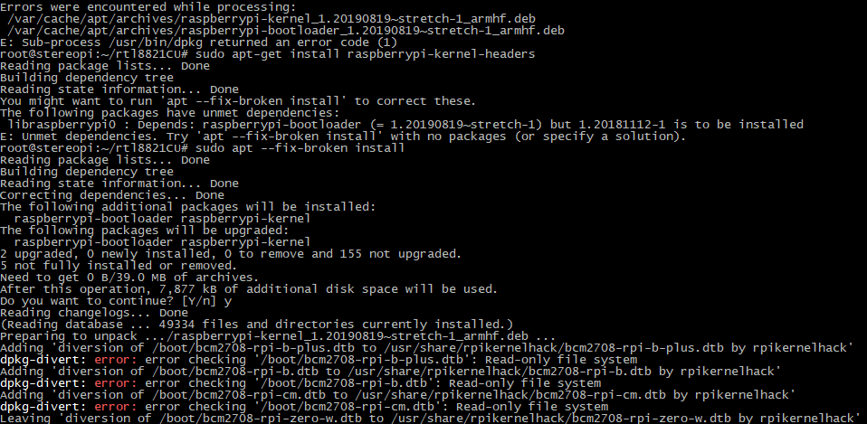

Trying to install sudo apt install raspberrypi-bootloader raspberrypi-kernel leads me to errors: read-only filesystem o_O
But i`ve already remount the filesytem as rw!
Why i go this way ? Because i went that way when install drivers for my usb dongle on openCV image that worked (see my comment https://github.com/gnab/rtl8812au/issues/147)
upd.
i remounted /boot with sudo mount -o rw,remount /boot and successfully updated bootloader and kernel but...
stereopi again starts boot endless...

Zoldaten, I just planned to suggest you unlock BOOT, but you find this by yourself! :-)
As for the reboot - as you mentioned, run.sh is the main file we start to run. So you can simplify it (by commenting) and find the reason for your reboots. All reboots we used have some special reason (like implementing updated partitions info). I hope you are having one of these "planned" reboots, but not a crash with updated kernel and bootloader... What is the last message you can see?
