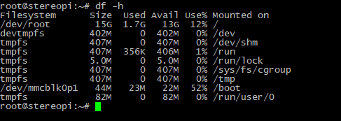

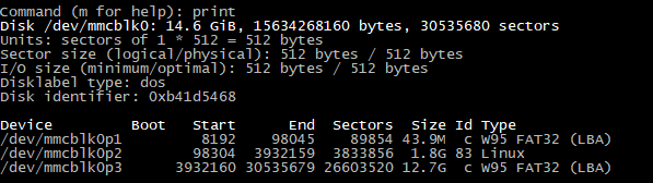

Secondly, i tried df -h and found out the partition table:

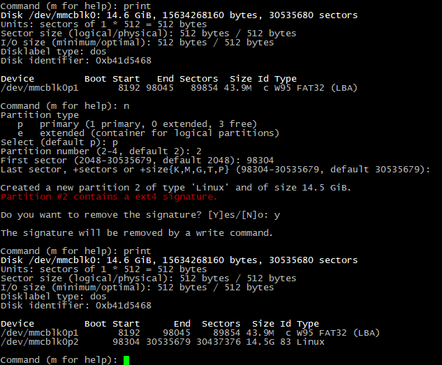

And tried to resize following the man here - https://raspberrypi.stackexchange.com/q ... -partition
But after delete partitions and reboot - stereopi went to endless reboot ((
How to resize in SLP image ?

On a Linux desktop with sd card reader, I used gparted with success. If you change the partition table with fdisk, you say where to search for new data but without moving the data themselves, hence the inability to boot.

To say briefly, after each boot SLP try to fond FAT32 partition, and if it is not existing - try to create it, using all free space... after it's 2Gb of ext4, i.e. 3932160 in our case. And does a reboot after that. So if you extend partition, this autoformat feature will feel itself bad.
This logic can be found in a file /opt/StereoPi/run.sh, rows 16-32. So if you will comment this code (or modify it for your needs), you will avoid rebooting and get right the thing you need.
UPD> As for the apt-get update (and upgrade) - this is not good idea, as after this procedure a lot of internal dependencies can be broken (like Nginx settings, PHP version and so on). Do it carefully please :-)

fdisk is a low level utility that modifies the partition table. You can work on such low level, but with extra caution and by knowing how the system works.
The step-by-step tutorial on your link (that I did not see at first read) is okay-ish, except that it destroys all partitions after the second one, which is not really a problem in the context of the question (a swap partition is somewhat optional). But this flaw is problematic with SLP because, as said by realizator, it tries to recreate a FAT partition at boot if it does not exist, but at a position which is not compatible with your new mapping.
You can probably resize with similar method at low level, but you should add a FAT partition (and perhaps format it, I do not remember exactly) to avoid the related script to trigger.
Alternatively on a desktop, you can use gparted (on a native Linux installation or with a liveUSB/liveCD) which is designed to resize partitions and handles various situations linked to this task. There still exist situations not suitable for it because they rely on partitions not being resized, but otherwise it is a great tool. Concerning SLP, the gparted method works because the requirement is the FAT partition to exist, which gparted keeps (and actually moves with content) if you do not ask it to remove.

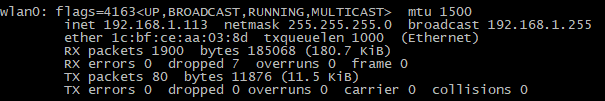

but as far as i went i did sudo apt-get upgrade and ...broke something. Cameras`re working (red lights flash on them) but no web-interface ))
Because of update i think.

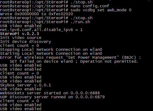

Tried to start script run.sh in /opt/Stereopi but it gives back:
May be something in config.conf should be change or in run.sh ?
Posts: 940
Re: apt-get update SLP image trouble
Zoldaten, apt-get upgrade is a bad thing, as I mentioned :-)
At least you can see the error stage - "Starting local network connection on Wlan0". Try to look in run.sh and find the workflow we use.
Some tips:
In run.sh we are starting wlan manager:
./scripts/wlan-switch.php &
this file includes "wlan.lib.php"
"wlan.lib.php" has LAN_stop and LAN_run functions.
Looks like your "Set power management" caused by row 164, i.e.:
shell_exec("sudo iwconfig $iface power off");
Also please take a look at row 178:
shell_exec('sudo wpa_supplicant -B -i ' . $iface . ' -D nl80211,wext -c /run/' . $iface . '.conf');
If you have updated driver, may be you need to put it here.
