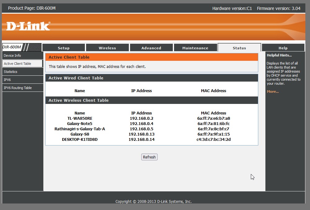

The connection was successful since you can see it as an active client on your router.
No! As I mentioned in the previous post, I can not see the device connected in the active client list.

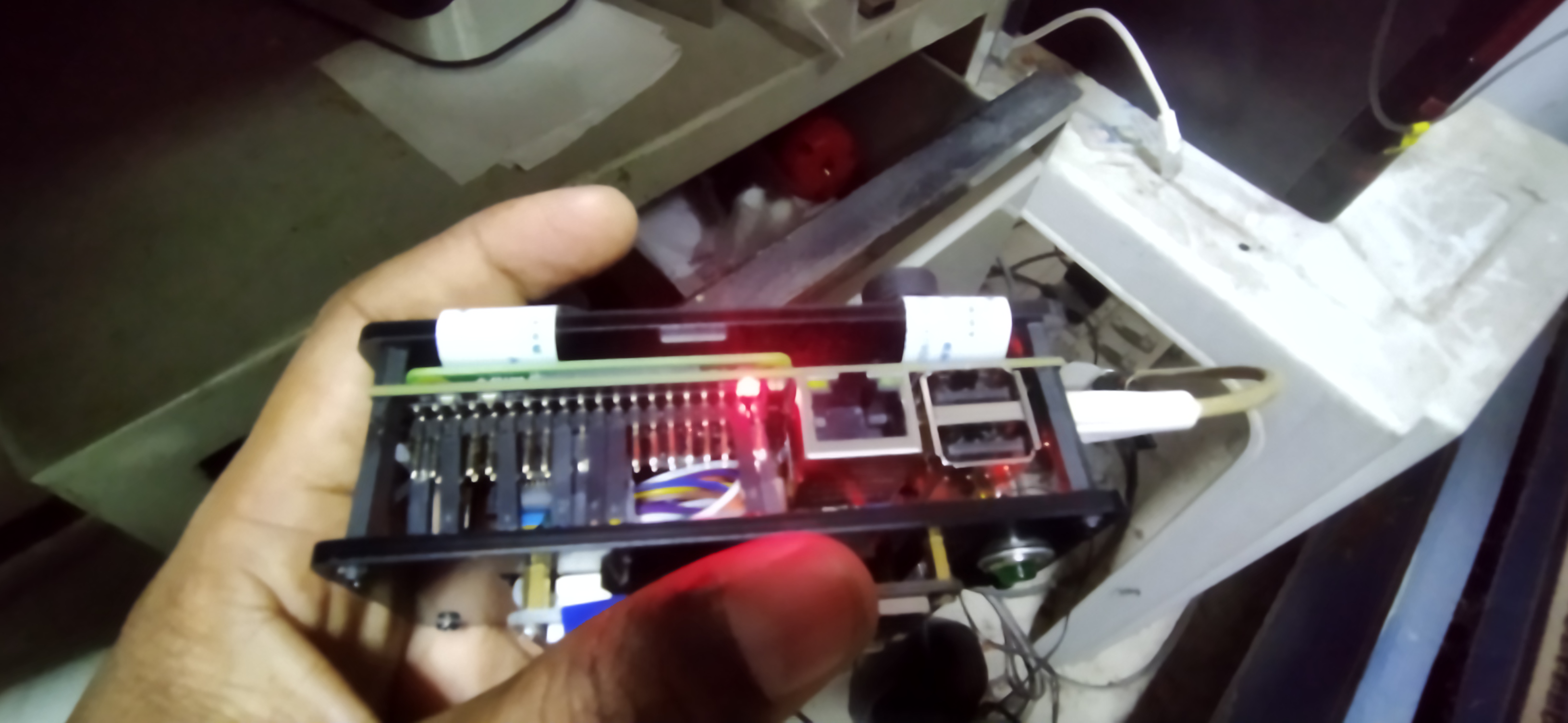

Now both the lights (Bluetooth, WiFi) are on.
But, I could not connect either using cosmostreamer access point or my own wi-fi router (after changing the cosmostreamer.conf file) or wired ethernet also. :(
When the ethernet connector is plugged in the green light is blinking. :idea:
I am not seeing StereoPi in the active client list of the router.
When I connect with Micro HDMI cable to a monitor, it says No signal. :(

Unfortunately until now I can't connect either through Ethernet or WiFi. :(
Wifi Green light is On. When I am connecting my Ethernet cable, orange color light is on. Green color light is blinking. I have made static ip disabled. (For making static ip I need MAC address in my router D-Link DIR-600M. (How to get?))

In my case, router doesn't show any device as connected. :(

When I type stereopi.local in Edge, it says, Hmmm… can't reach this page
When I used Cosmostreamer desktop version I got the following screen and it doesn't pick up the StereoPi.
1. I will verify from my home router and revert back whether the same thing happens.
2. Whether we need country code to be setup for Ethernet also?
An update:
From the home router also, I don't see StereoPi in the active client table.
Whenever green color light is blinking in StereoPi, the Tx Pkt number is getting increased.

By the way, when you are using the fresh SLP installation and boot the StereoPi, are you able to see the "cosmostreamer" WiFi access point from any of your devices?
Is ACT_LED blinking while the boot process?
Your issue looks unusual to me. Maybe I will do a replacement for you.
Could you please try to do one more thing - please connect the monitor to the micro HDMI output of the StereoPi. This is the last thing I can check remotely.
Re: How to connect via WiFi
Posted: Sun Feb 13, 2022 1:23 pm
by srathinagiri
I have tried to connect thru Micro HDMI and I am getting the following screen.
I hope now you can guide me what to do!
