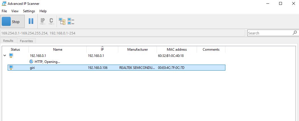

I have used an IP Scanning software and I can not see StereoPi.

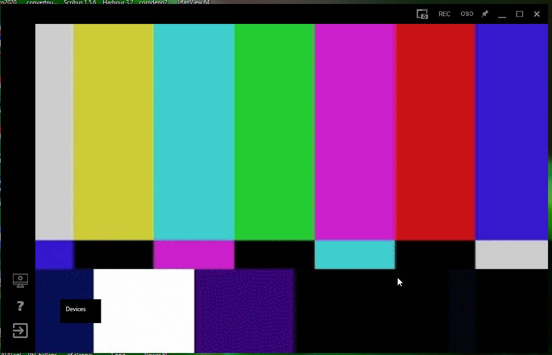

When I used Cosmostreamer desktop version I got the following screen and it doesn't pick up the StereoPi.

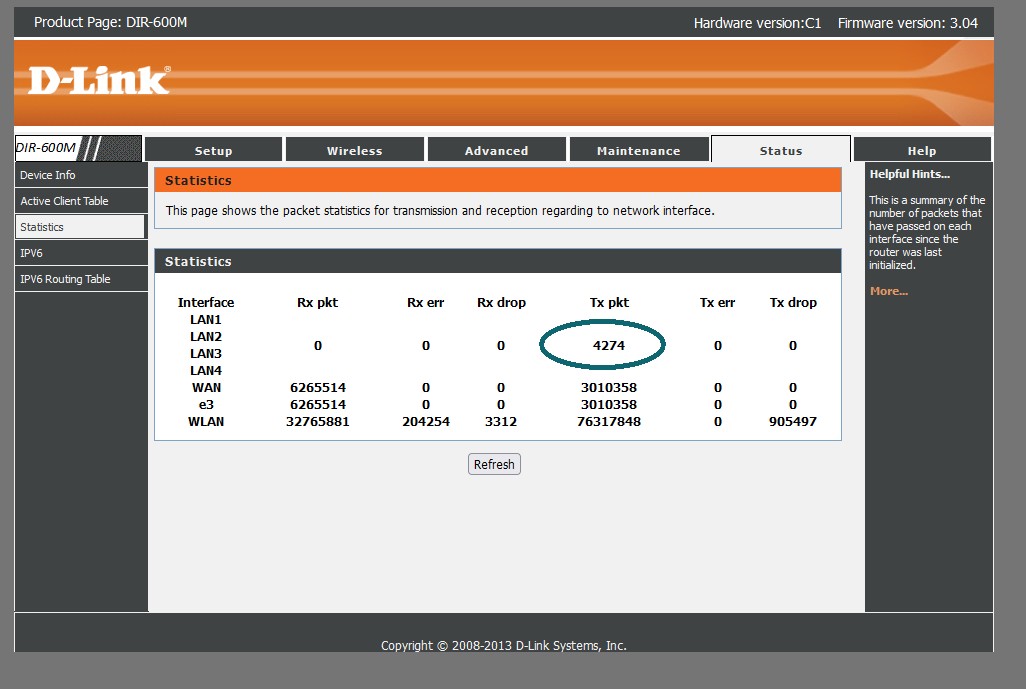

From the home router also, I don't see StereoPi in the active client table.
Whenever green color light is blinking in StereoPi, the Tx Pkt number is getting increased.

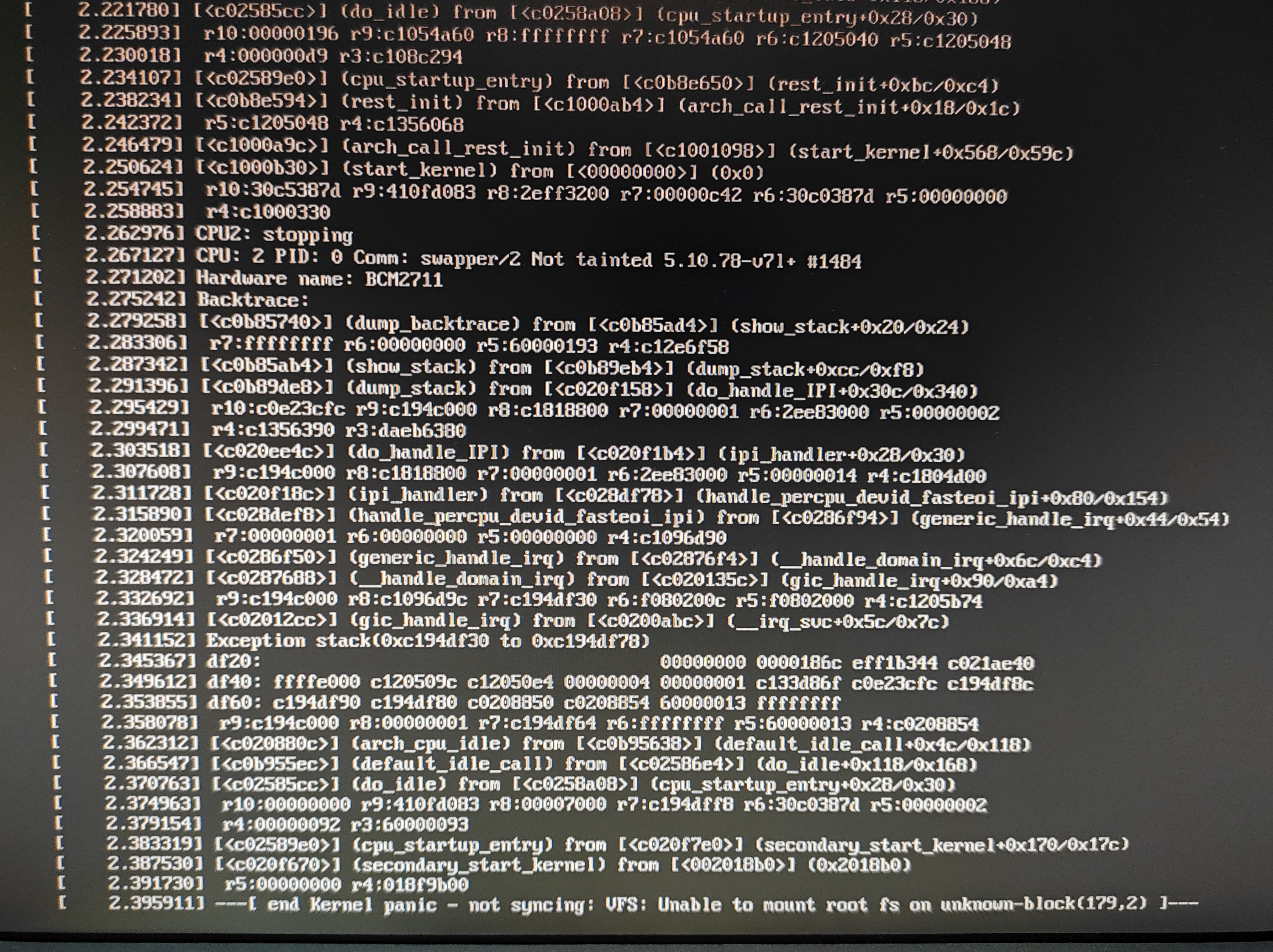

Could you please try to do one more thing - please connect the monitor to the micro HDMI output of the StereoPi. This is the last thing I can check remotely.

I have tried to connect thru Micro HDMI and I am getting the following screen.
I hope now you can guide me what to do!
