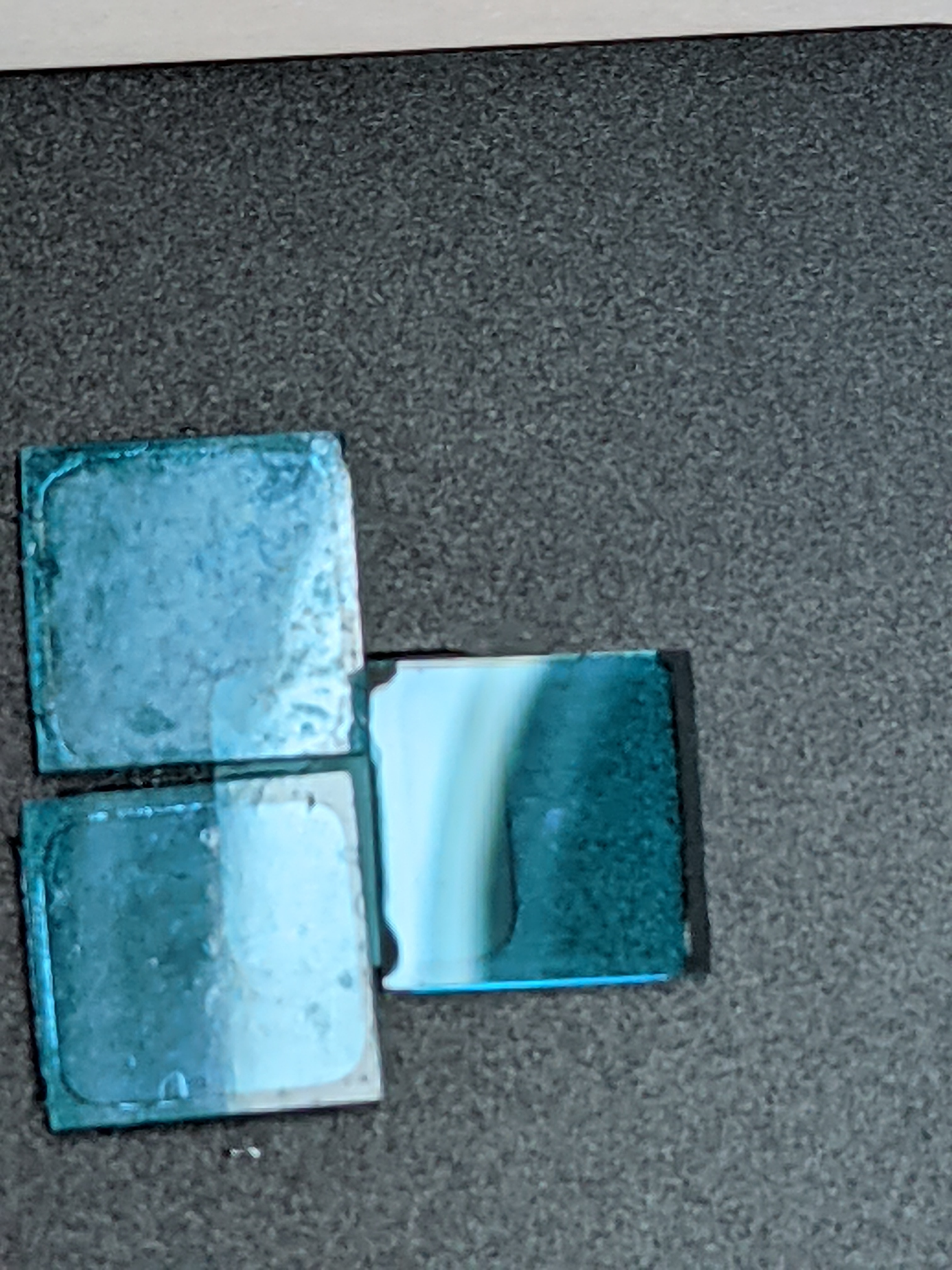

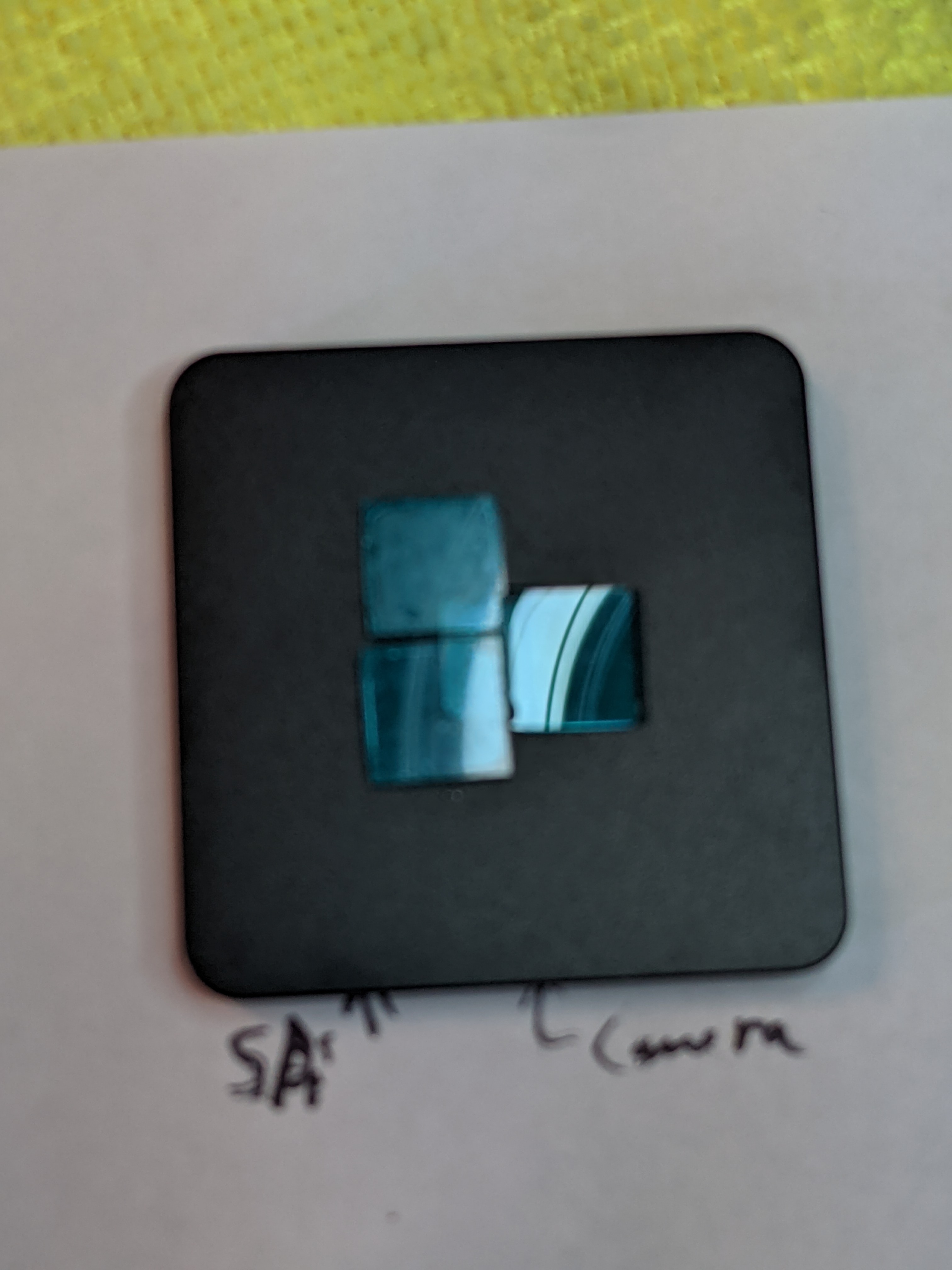

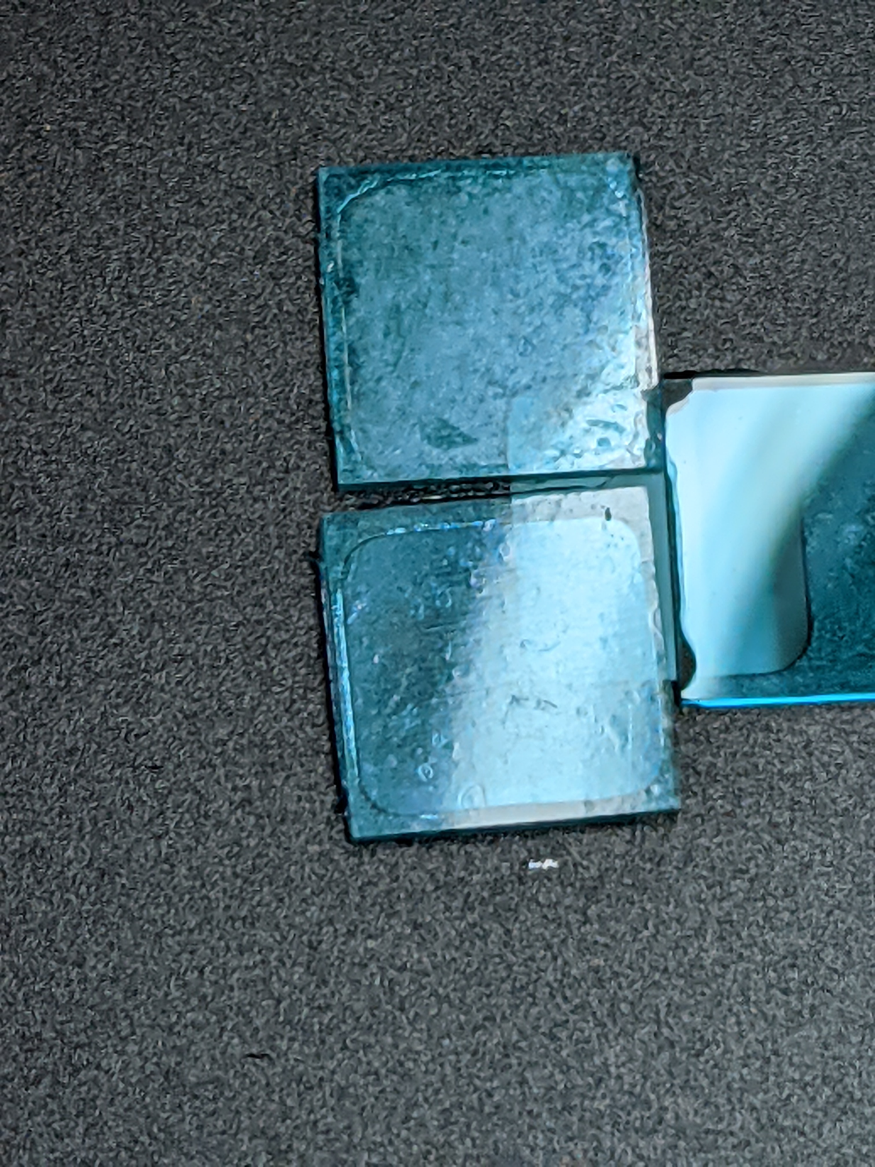

the extra ir filters look like they have some sort of protective film, but I can't get it off... was able to remove the ir filter from the HQ camera to compare, have attached some pictures-- the filter on right is out of the HQ camera the two on the left are from the stereoPiV2 CNC camera housing kit.
the camera filter reflects perfectly, like a mirror... the other two just look bumpy, as if there is a plastic film on them....
I used some UV cure optical glue to put filters onto the camera housing and that worked really well.
Anyone else have close shots of the ir filter?
thanks!

Wow... I never saw the CM500 filters in the condition of items that are on the left side of your photo...
We got CM500 filters directly from the HOYA company (Japan), and they are packed in trays (look at the photo).
I can't remember any films or other items attached. They should look like polished, mirror-like glass.
Also, I'm curious about the strange signs on them (like a square with rounded corners).
Have they arrived in this condition with the kit?

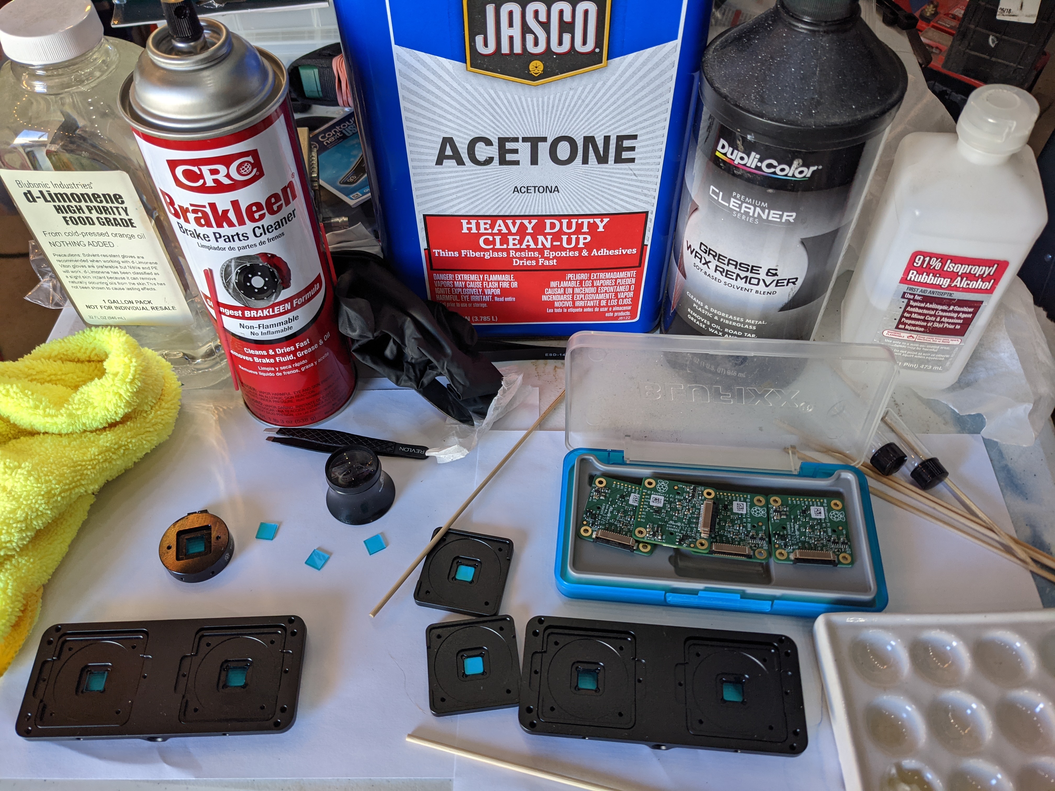

Re: ir filter.. protective film?
yeah the rounded edge was because I had glued them into onto the aluminum carrier plate and later pushed them out-- I had used a uv-cure glue called "blufixx" and it spread more than I thought it would with capillary action(so that made the rounded edge).. but noticed the ir filter looked like it had a film on it prior to gluing it in, just wasn't sure what it was supposed to look like until I took apart the HQ cameras.
So I have 10 filters; 6 from the kit and 4 from HQ cameras, honestly only two are perfect Two other ones from the HQ camera have some spots and all six the the kit look like there is a film on them.
I have a variety of solvents... so I just tried to see if anything worked, acetone, brake cleaner, 91% isopropyl alcohol, wax and grease remover, d-limone and even a Razer blade had no results. (will, it did remove the uv glue)... am really flummoxed about it.
I will see if I can source some of them -- I am in Houston right now for next two weeks...
Lincoln
Lincoln
I too noticed what looked like a protective film on my filters. It's my belief though that what we're seeing may be a chemical film picked up from the plastic bags they were packed in .... most likely a release agent (silicone?) used in the manufacture of the bags.
Certainly, my filters were clinging quite strongly to the inside of the bags.
my filters look the same and are completely unusable. My guess is because of the plastic bags. where can i get replacement filters?
I just ran into this with filters from Welectron (which is the only place I could find that sells them 2 at a time). I got the gunk off by soaking in acetone and then using a safety razor blade. Fussy and annoying.
