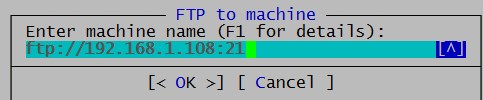

So to do so u just need to upload optimized images and replace old ones. It can be tricky as there`s no VNC.
I recommend ftp. For example - https://www.xlightftpd.com/
After that u can upload them this way:

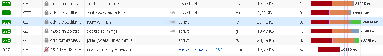

Additional optimisation.
Web file-manager.
Web-page time load before:
After optimisation:
What have done ?
All external links of js and css put to filesystem (most of all).
To do that you need put updated index.php to /var/www/html/files
And js and css after unpack to /var/www/html/files/js

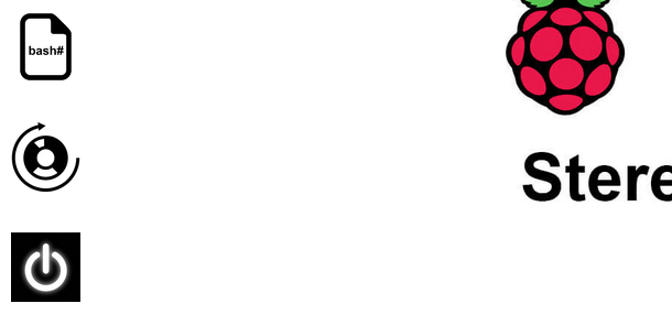

i`ve added to the web-page shutdown button.
It looks like this -
On push it just shutdown stereopi :mrgreen:
To do the same put to /var/www/html updated index.php -
index.rar
(4.09 KiB) Downloaded 2056 times
and to /var/www/html/imgs -
shutdown_icon.rar
(26.68 KiB) Downloaded 2041 times
(after unpack ofcause).
Make shutdown.php at the same dir where index.php is and put in it 1 string:
<?php system('sudo /sbin/shutdown -h now'); ?>
Make shutdown.php executable:
chmod +x shutdown.php
