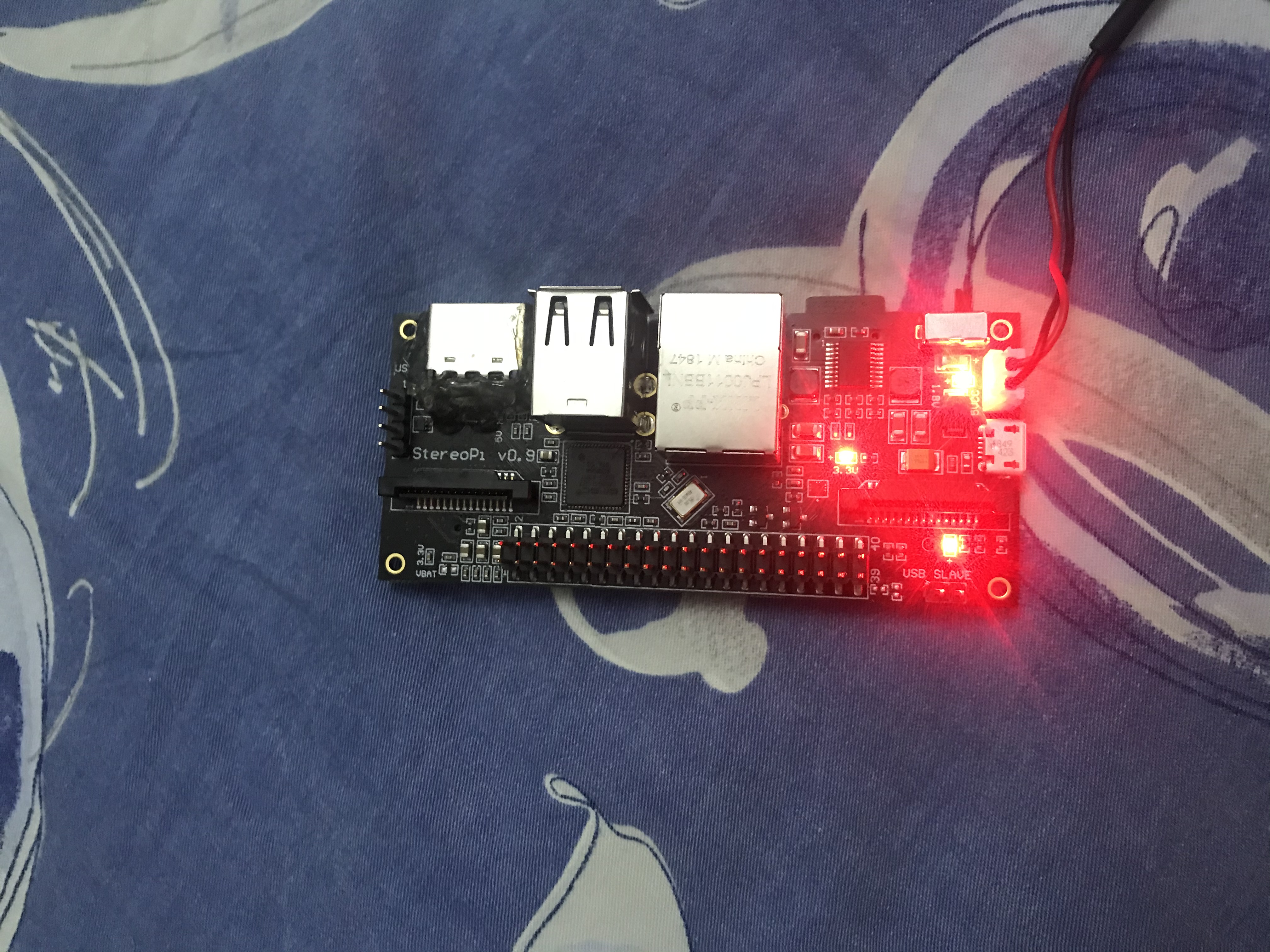

Re: Ethernet port lamp not working
Actually it seems like I am facing similar issue. My stereopi suddenly stopped working today and doesn't seem like the board is attempting to boot (all three red leds stay static no, no blinking). I don't see any soldering issues or components coming out and I did make sure that the compute module is inserted properly.
The SD card seems to be working fine since I booted using the same sdcard on another rasberrypi (I am using the raspbian image and not the SLP image). Attached is the picture of my board.
upload a photo
upload a photo

Aditya-sf , I see T-connector on your photo and hi-current wires from it. I hope they come from BEC, but not from the LiPo battery. Can you please confirm you are using 5V for powering the StereoPi?
I also mentioned you are using the GPIO powering method, but this should not be an issue. Can you please confirm, that both JST connector powering and micro USB powering methods give you the same result?
Yes the power is through BEC (5V output) and not from LiPo directly. I tried other methods of powering it but the same result.
