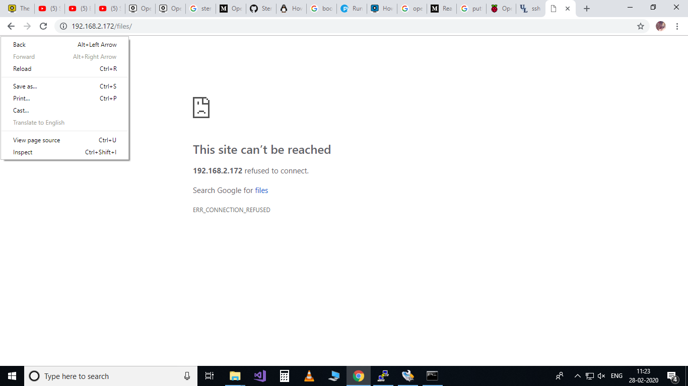

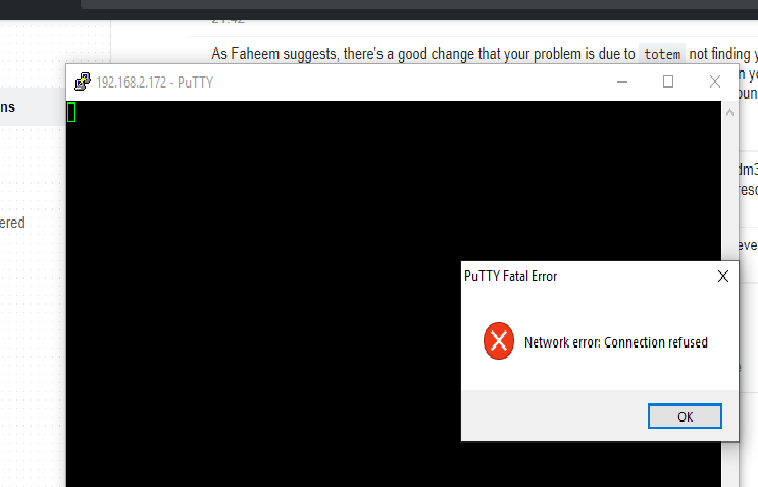

Helloo
I have booted the opencv raspbian image to sd card,put the video is not playing in web brower why? and in puTTy as it giving networ error.
if possible can u tell me the steps after booting the image to the sd card(softwares need to use),further I'll refer the videos what you suggetsed.
Thank you...
Thank you...
Re: How to work with Stereo Pi
u can go through the attached files
- web.png (68.25 KiB) Viewed 146669 times
- putty.png (16.69 KiB) Viewed 146669 times
- Posts: 940
OpenCv image is not intended for the video livestream to the browser. It's absolutely another task, which requires a lot of code. All that code is included in SLP image.
I asked you to repeat all the steps from the first video with the C++ code. There are no any livestream to the browser here. If you can repeat it, a lot of things will be much clear for you. To do all these stepes you need to connect a keyboard, mouse and a monitor to your StereoPi, but not access it over Putty.
Also please notice, that by Putty you can access the terminal only. You are unable to see desktop, graphics, image preview etc.

If I cant access putty..then how should i can proceed? I'm very new to this environment.
