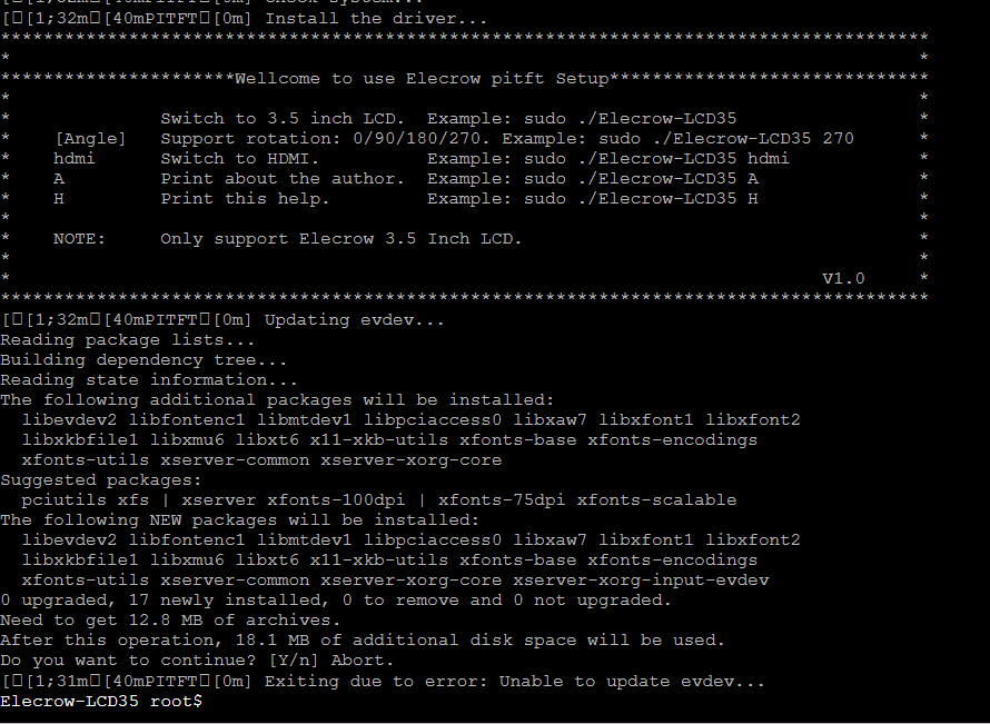

I am installing the screen 3.5 and gives this error

The error is just written in the log very explicitly: you do not have enough free space (to download the software your installer try to add).

Yep, Stereomaton is right, not enough space.
Well, looks like a lot of peoples trying to install some more stuff to our S.L.P. image.
So today I'll prepare S.L.P. with not 2Gb, but 4Gb partition size. I'll put a link here. Hope it will help you to avoid this error.

Linux partition tooks 4Gb regardless of your micro SD card. In your case you’ll have 60Gb space for photo and video, and 4Gb for Linux.
Also, according to your photo, the problem is not with the fee space now.

The installer script possibly try to install the software without updating the list of available packages in the repository, thus maybe it tries to download something that was updated between the last update and now.
Try to run "apt update" to update list list of packages before running your installer again.
