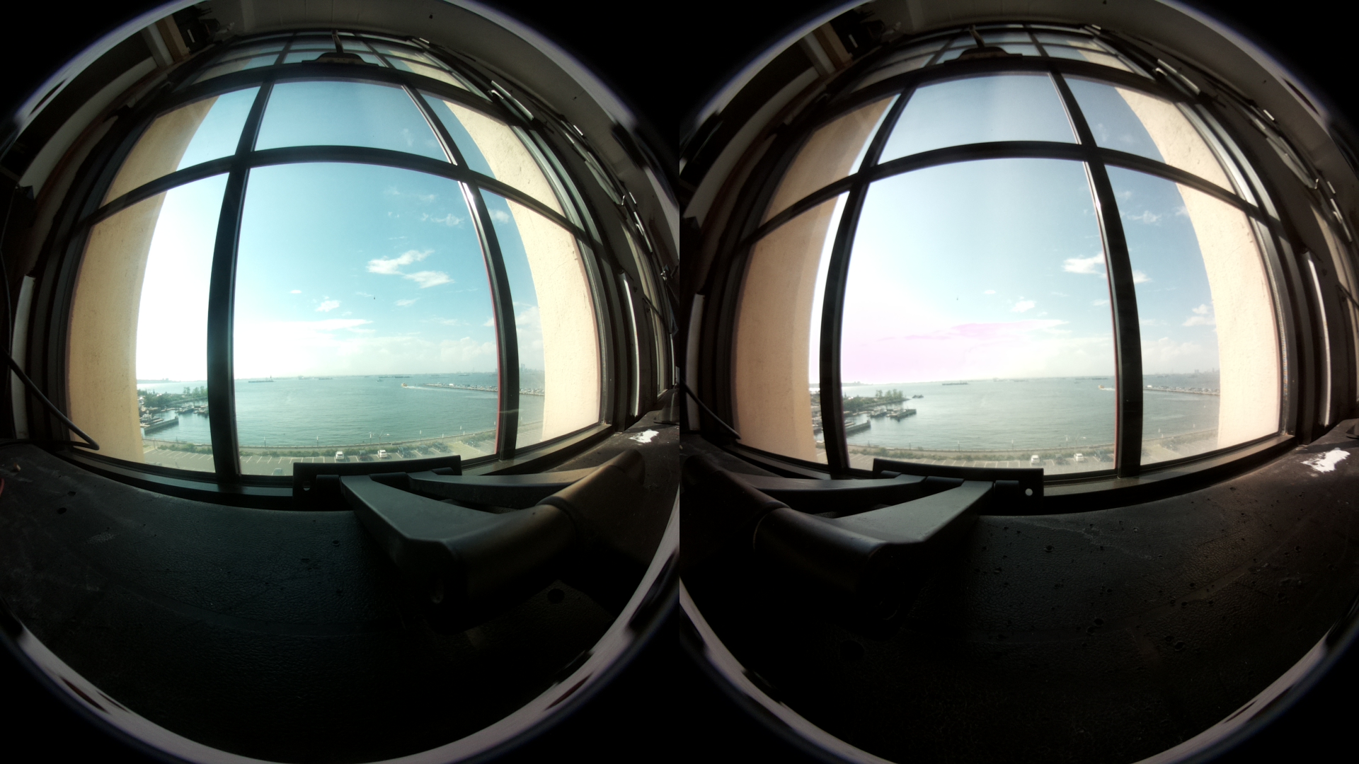

I had a chance today to load up the Raspberry Pi OS (minimal), installed all updates, etc. and gave it a few tests.
Unfortunately this didn't solve the issue with the SainSmart 200 degree FOV cameras _or_ the official Raspberry Pi v2.1 cameras.
After I installed the new version of the OS and got everything updated, I ran the test you mentioned below:
The first result showed the same effect as before using the SainSmart cameras:
SainSmart Cameras 200 Degree FOV with Raspberry Pi OS:
Out of curiosity, I moved the cameras closer to the window to see what it would do with the change in dynamic range.
Close to window:
Away from window:
Against window:

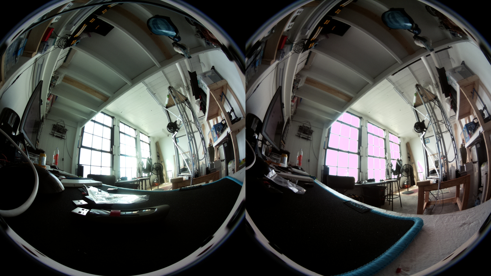

At this point I decided to try the official Raspberry Pi v2.1 cameras with the Raspberry Pi OS and got some strange results. In the first image, it seemed fine but then I noticed some magenta but this time it's in left camera.
Raspberry Pi v2.1 cameras w/ Raspberry Pi OS:
On the second test, I changed the perspective and white balanced with a quick flash of my hand. You can definitely see the magenta back in the right camera, similar to the SainSmart camera.
On the third test, I placed it up against the window and the results are quite a bit different between the two cameras.
Any thoughts?

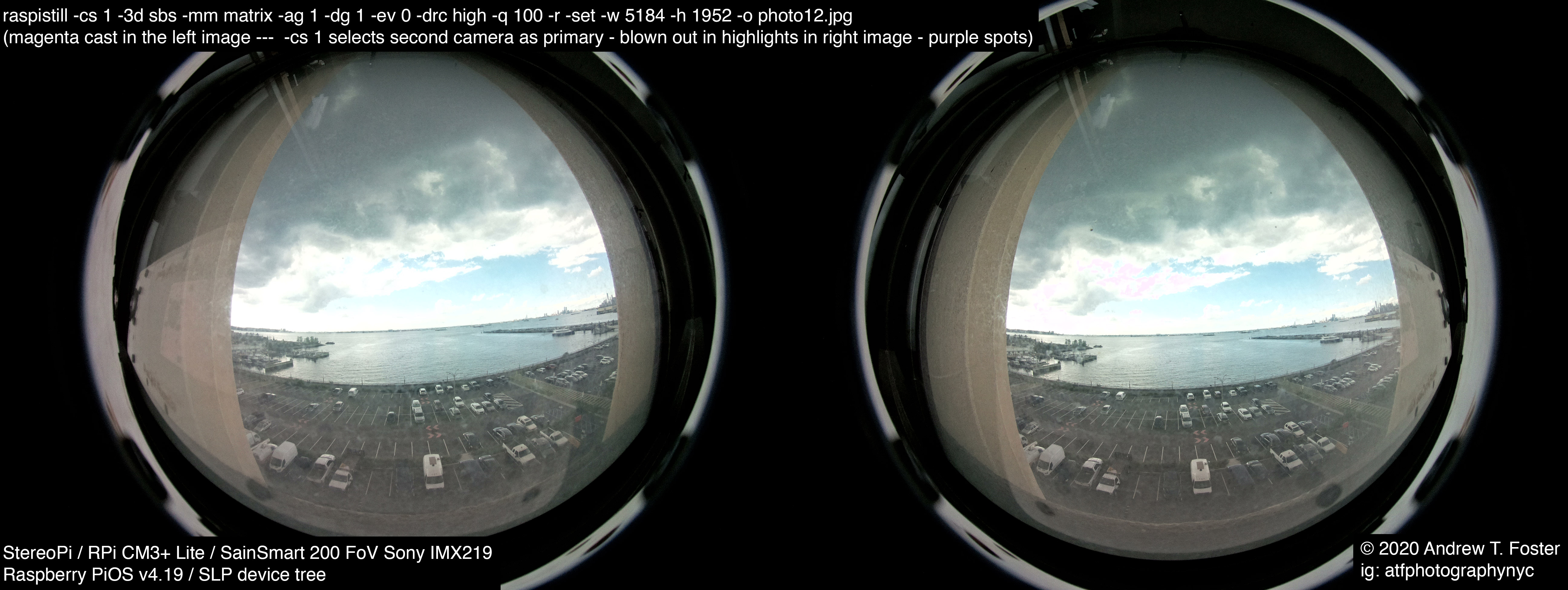

I ran a few tests yesterday as requested. Let me show you the results for the camera switch request;
"To confirm this hypothesis, can you please do one more test, and do a software switch of the cameras. To do this, add the "-cs 1" option to your capturing code. I.e. for your "raspistill -3d sbs -w 1920 -h 1080 -o newtest.jpg" try to run "raspistill -cs 1 -3d sbs -w 1920 -h 1080 -o newtest.jpg"
In this case, your magenta color effect should "jump" to another camera."
The same setup as before for the first set;
StereoPi
SainSmart 200 degree FoV - SONY IMX219 - CMOS 1/4 Inch - 3280x2464 - Focal length 0.87mm - Aperture (F):2
CMS3+ lite
SD Card
Raspberry Pi OS 4.17 with the device tree blob
The first test showed similar results.

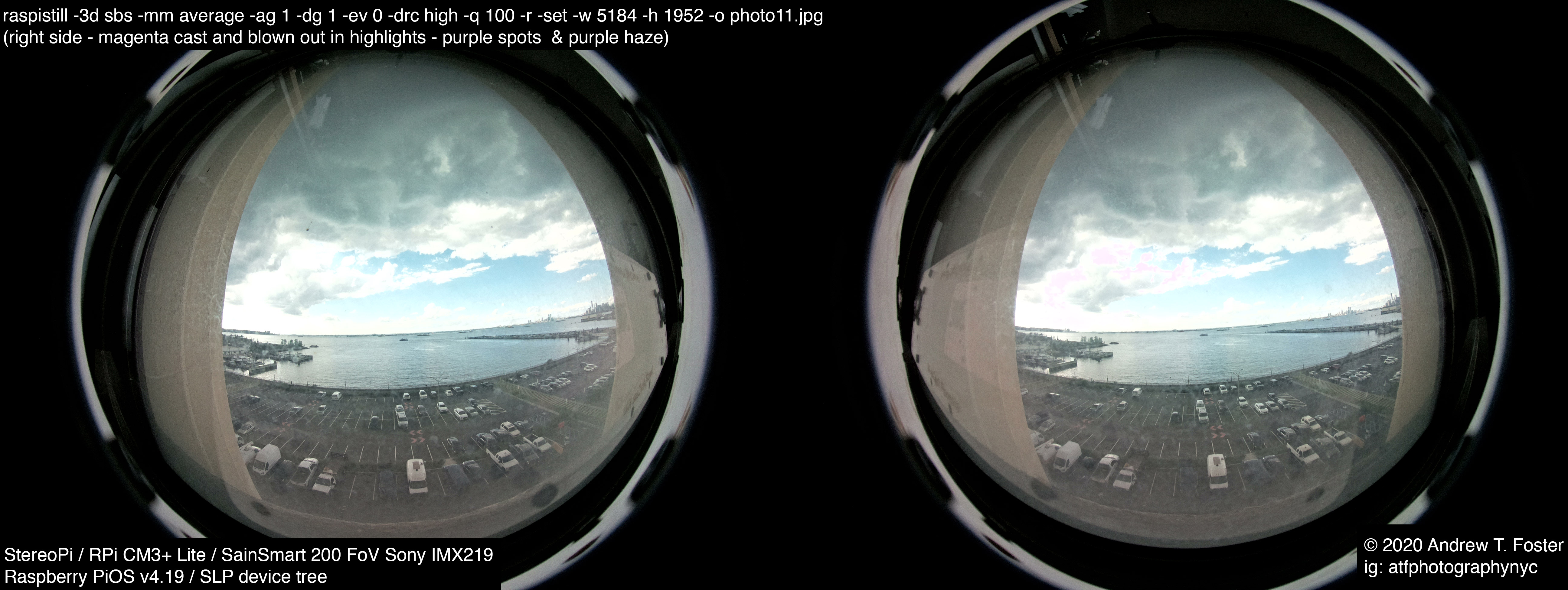

In the first frame, Magenta in the right image and purple spots or purple haze in the highlights.
Capture Command: raspistill -mm matrix -ag 1 -dg 1 -ev 0 -drc high -3d sbs -q 100 -r -set -w 1920 -h 1080 -o newsettings22.jpg
The second frame of the first test the magenta moved to the left, BUT the purple spots and haze in the highlights did not change.
Capture Command: raspistill -cs 1 -mm matrix -ag 1 -dg 1 -ev 0 -drc high -3d sbs -q 100 -r -set -w 1920 -h 1080 -o newsettings23.jpg

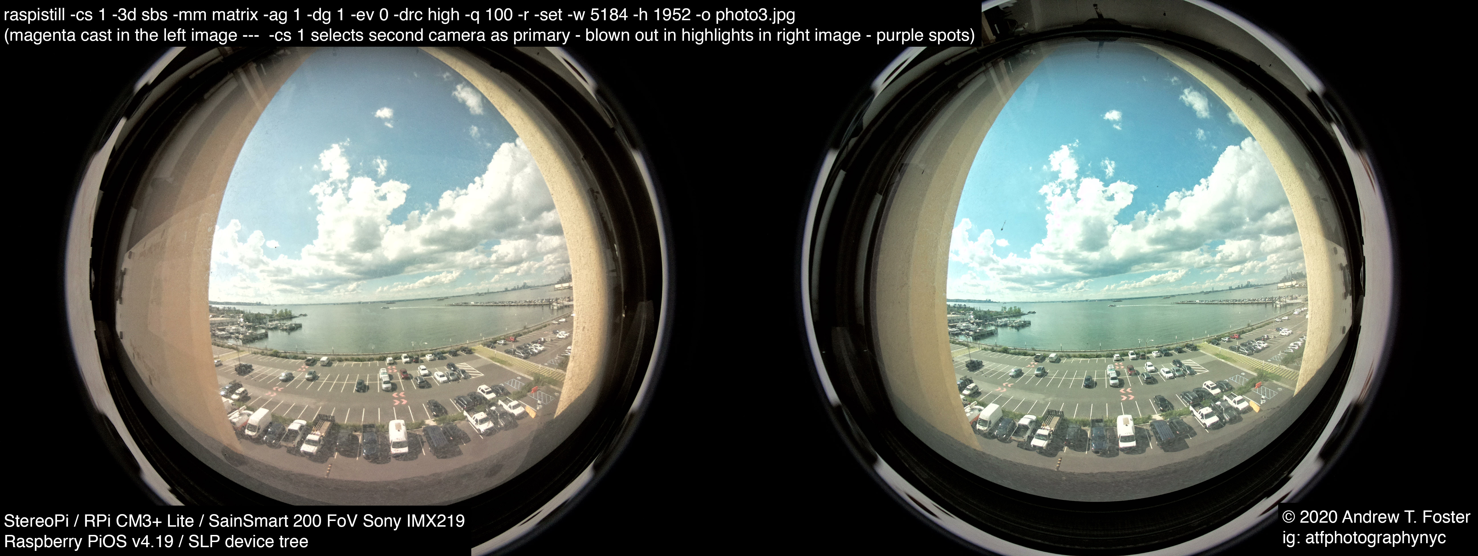

The next test first image shows a similar problem with the magenta but somehow the purple spots are barely visible:
Capture Command: raspistill -3d sbs -mm matrix -ag 1 -dg 1 -ev 0 -drc high -q 100 -r -set -w 5184 -h 1952 -o photo2.jpg
The second frame shows the magenta has moved to the left. No change in barely visible spots on right.
Capture Command: raspistill -cs 1 -3d sbs -mm matrix -ag 1 -dg 1 -ev 0 -drc high -q 100 -r -set -w 5184 -h 1952 -o photo3.jpg

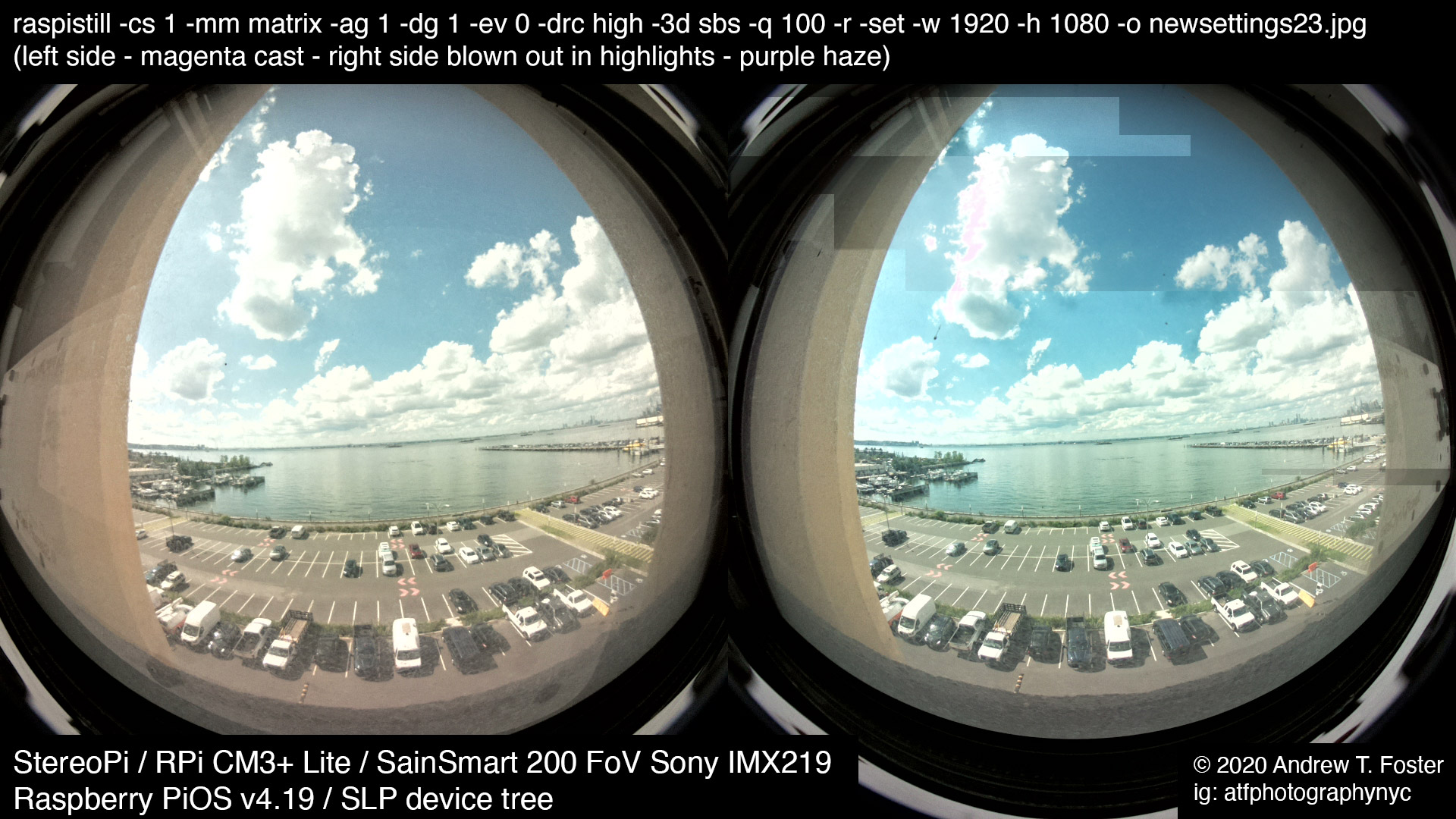

In this next test I tried some adjustments to the command line parameters for raspistill and used -mm matrix for these two images. The magenta was heavy in the right image and the purple haze is pronounced in the highlights.
Capture Command: raspistill -3d sbs -mm matrix -ag 1 -dg 1 -ev 0 -drc high -q 100 -r -set -w 5184 -h 1952 -o photo10.jpg
The second frame of this test shows the magenta move to the left side, but the purple haze remains in the highlights on the right.
Capture Command: raspistill -cs 1 -3d sbs -mm matrix -ag 1 -dg 1 -ev 0 -drc high -q 100 -r -set -w 5184 -h 1952 -o photo11.jpg
At this point, I decided to try another completely different set of the cameras. The images below all use the same model that I acquired of the SainSmart from the same vendor.
With the cameras swapped out, I noticed that the new set of cameras has far less of a magenta cast issue. It's still there but it's not as pronounced as the other camera set. I have _no_ idea why this true. In this test I tried some adjustments to the command line parameters for raspistill and used -mm average for these two images. The magenta was much lighter in the right image but the purple haze is still pronounced in the highlights.
Capture Command: raspistill -3d sbs -mm average -ag 1 -dg 1 -ev 0 -drc high -q 100 -r -set -w 5184 -h 1952 -o photo12.jpg
Capture Command: raspistill -cs 1 -3d sbs -mm average -ag 1 -dg 1 -ev 0 -drc high -q 100 -r -set -w 5184 -h 1952 -o photo13.jpg
So it seems that there are two issues:
1. A magenta cast is covering the image in the camera that is receiving settings from the host camera.
2. In the right camera, the highlights are blown out and change to purple dots or a purple haze regardless of using the -cs (camera selection) command.
Hope this helps and I labeled everything correctly.
A
P.S. I wish I could clean the windows on the outside. Ha!

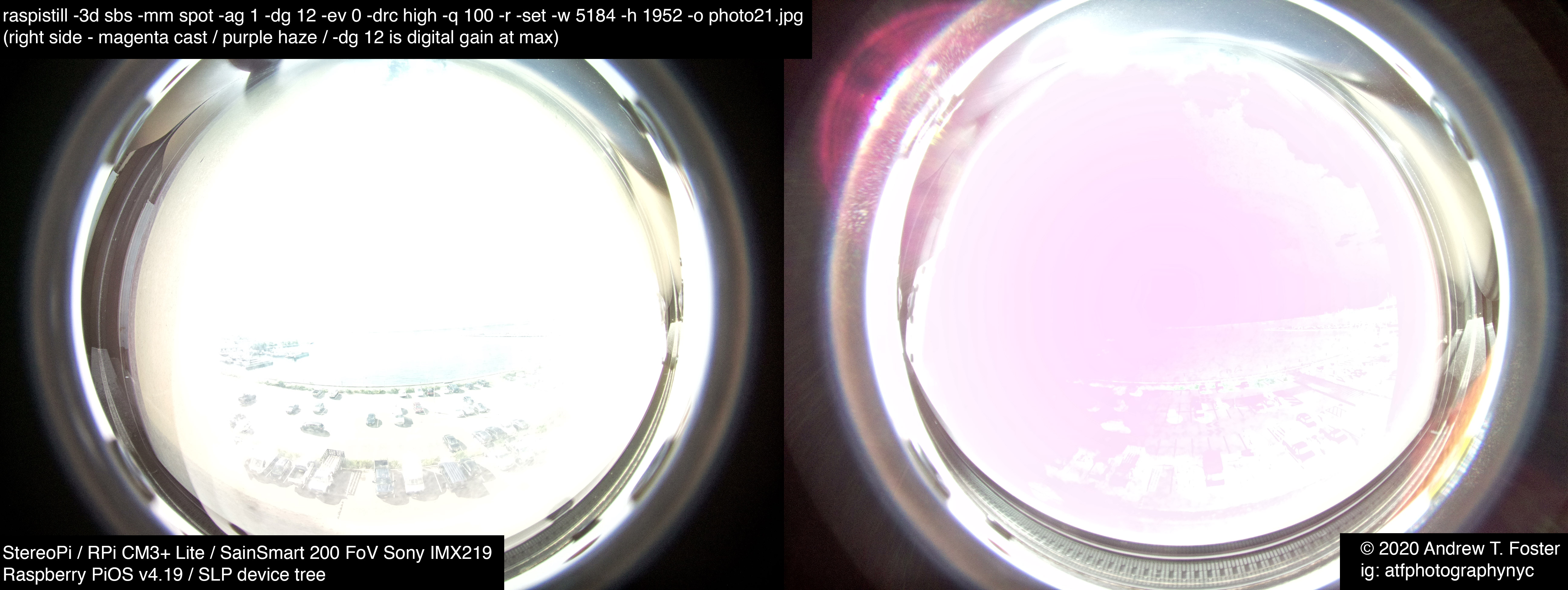

One more image. This image was a test when I was playing around with the parameters for the analog and digital gain.
I had cranked the digital gain up all the way to see what the effect was on the image.
raspistill -3d sbs -mm spot -ag 1 -dg 12 -ev 0 -drc high -q 100 -r -set -w 5184 -h 1952 -o photo21.jpg
You can really see the magenta in the image on the right.

Posted: Fri Apr 09, 2021 6:25 pm
Aftphoto, thank you for your tests!
Could you please do the last test - check the same thing using the latest stock Raspbian and our dt-blob.bin?
In my own experience, this effect appears only in some special conditions. Like image should have both extremely dark areas (corners on the fisheye photos) and extremely light (sun or sky). I'll ask RPF again to fix this.

Guys, looks like RPF is not planning to fix this issue (as 6by9 told here).
My investigation shows that magenta cast can be fixed by after-processing. We need to increase G to the maximum for any RGB point, where R and B > 249 and G>207. I checked this approach with all photos in this thread, and it works fine.
Example:
Before:
After:
The row I used with ImageMagick is:
magick f4.jpg -channel green -fx "((u.r>0.973) & (u.b>0.973) & (u.g>0.81)) ? u+0.19:u" f4_fixed.jpg
I know this is a bandage and a workaround, but we can use this for post-processing images taken with IMX219 and IMX477 sensors.
