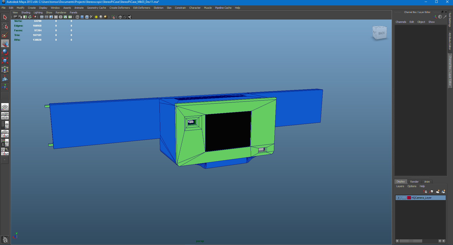

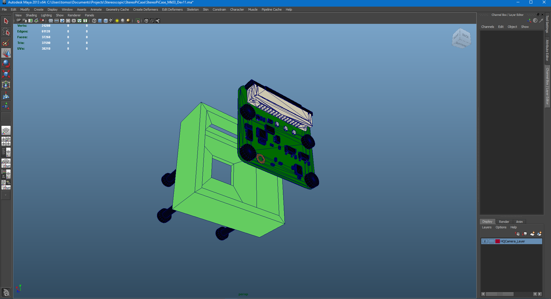

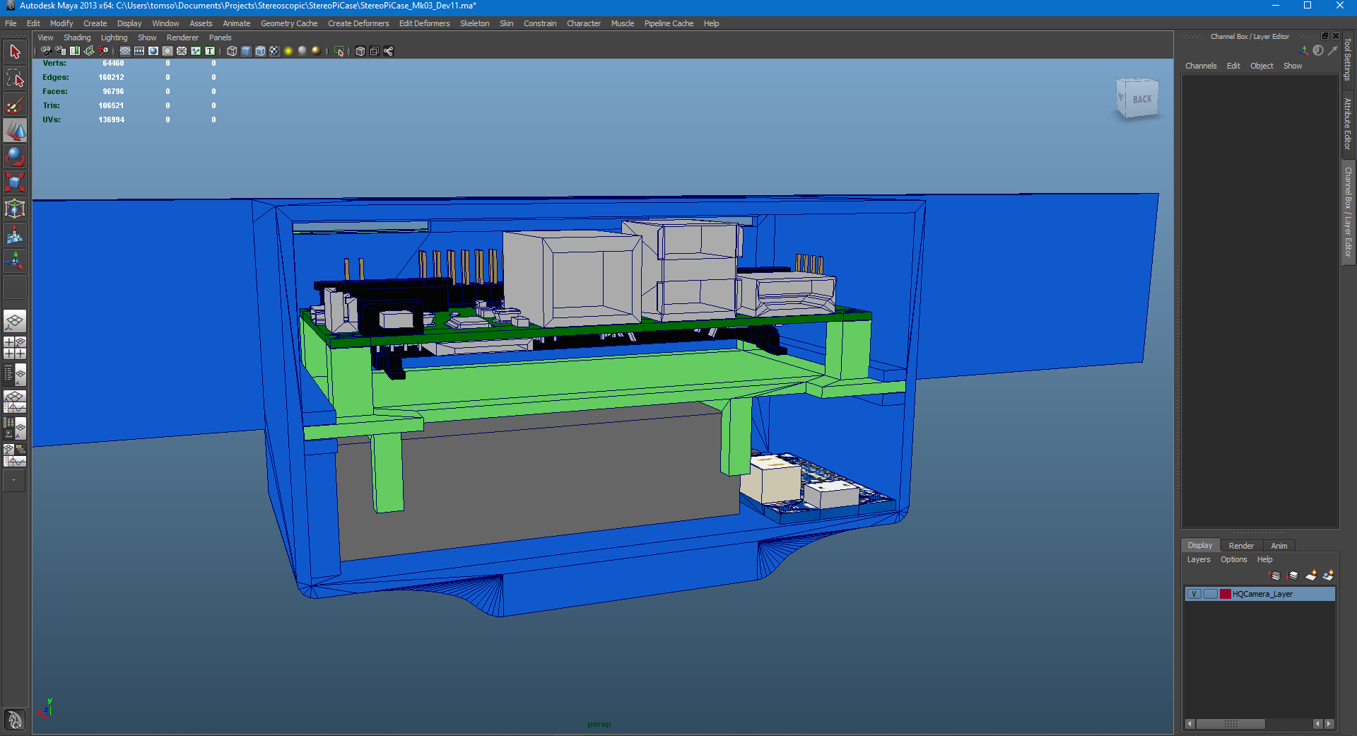

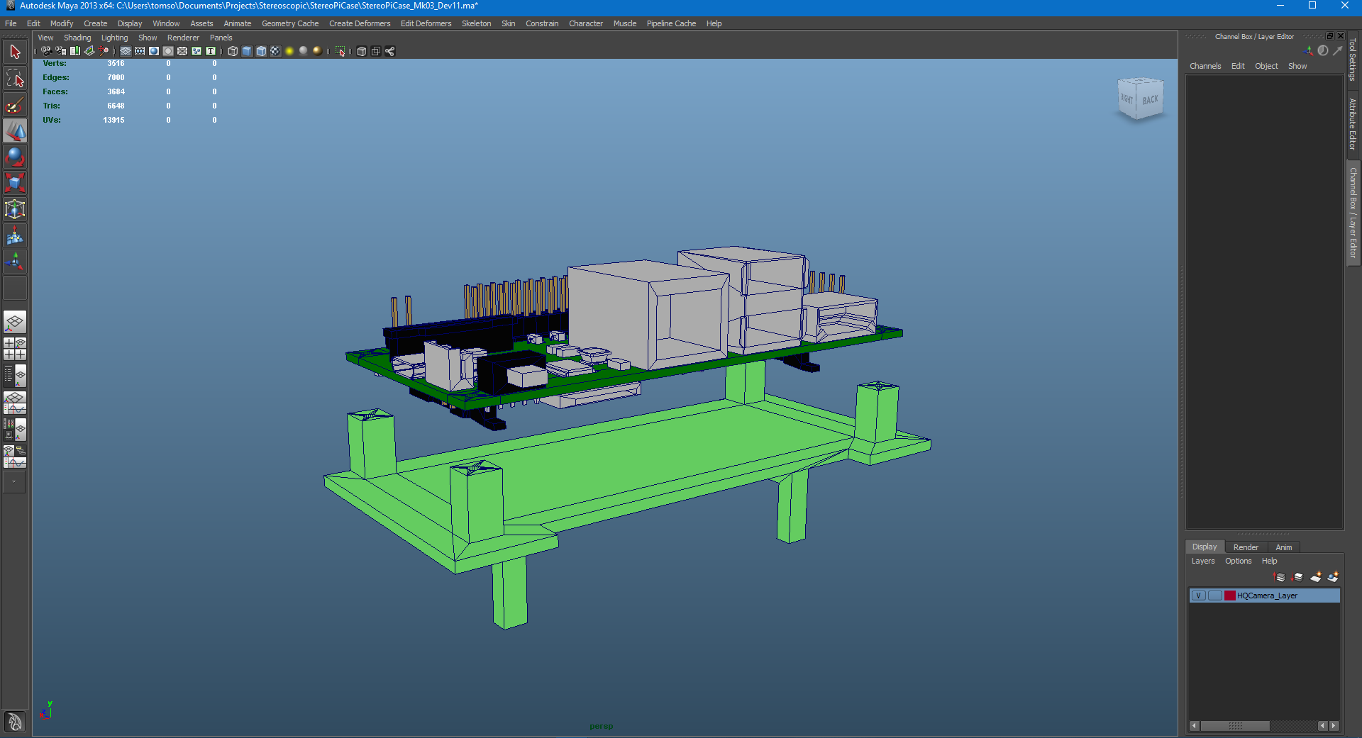

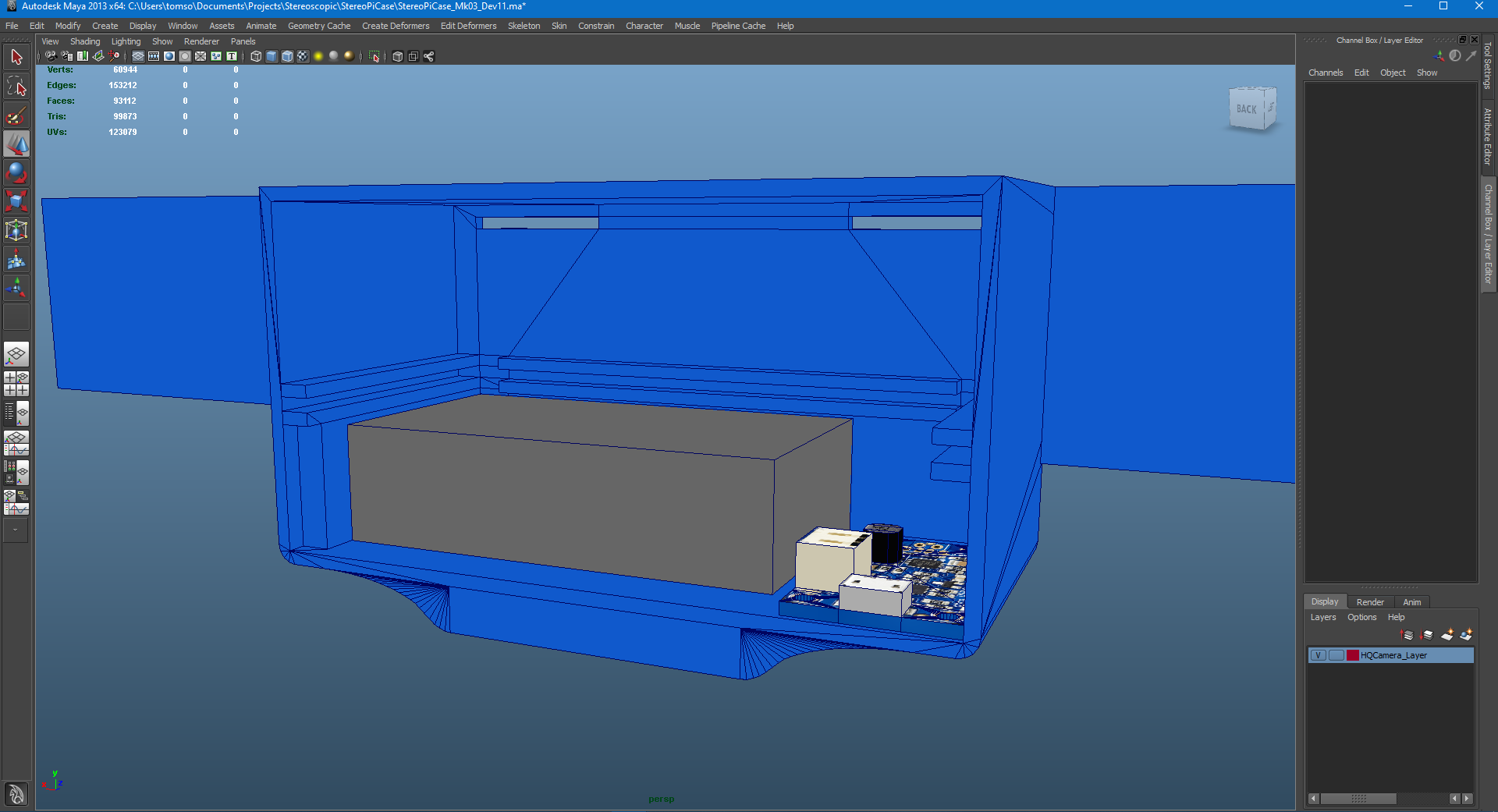

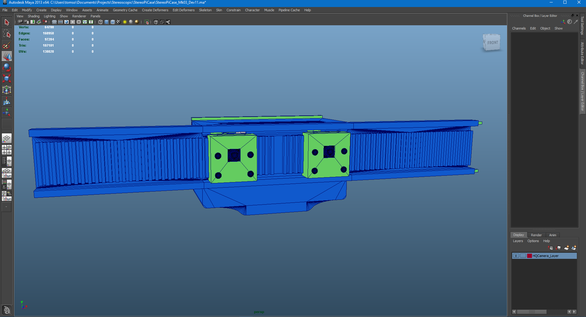

I've attached a few images of the modular case design. The High Quality camera attachment is a work in progress and isn't particularly a priority right now, but most of the work for the typical Raspberry Pi type cameras is done ;)
I've uploaded a few images. I still need to bevel the top edges so they're better to hold whilst holding the camera. Let me know what you think!
EDIT: I tried uploading more but I could only upload three, odd!

A-ha, you're planning to do a variable stereobase! Cool!
As for the button - we have a simple Python script for this, designed for the SLP Raspbian image.
If it will be a screen on the back of the case, or you will use a phone as a viewfinder? Or this is a remote setup for the birds photo hunting?
UPD> I've increased number of images per post from 3 to 10, specially for you :-)

TomDev wrote: Fri Jun 05, 2020 9:33 pm I've attached a few images of the modular case design. [...] Let me know what you think!
It looks nice with apparently a compartment for a battery and adjustable baseline.
Let us see the prototype in action ;-) and share the case (?).

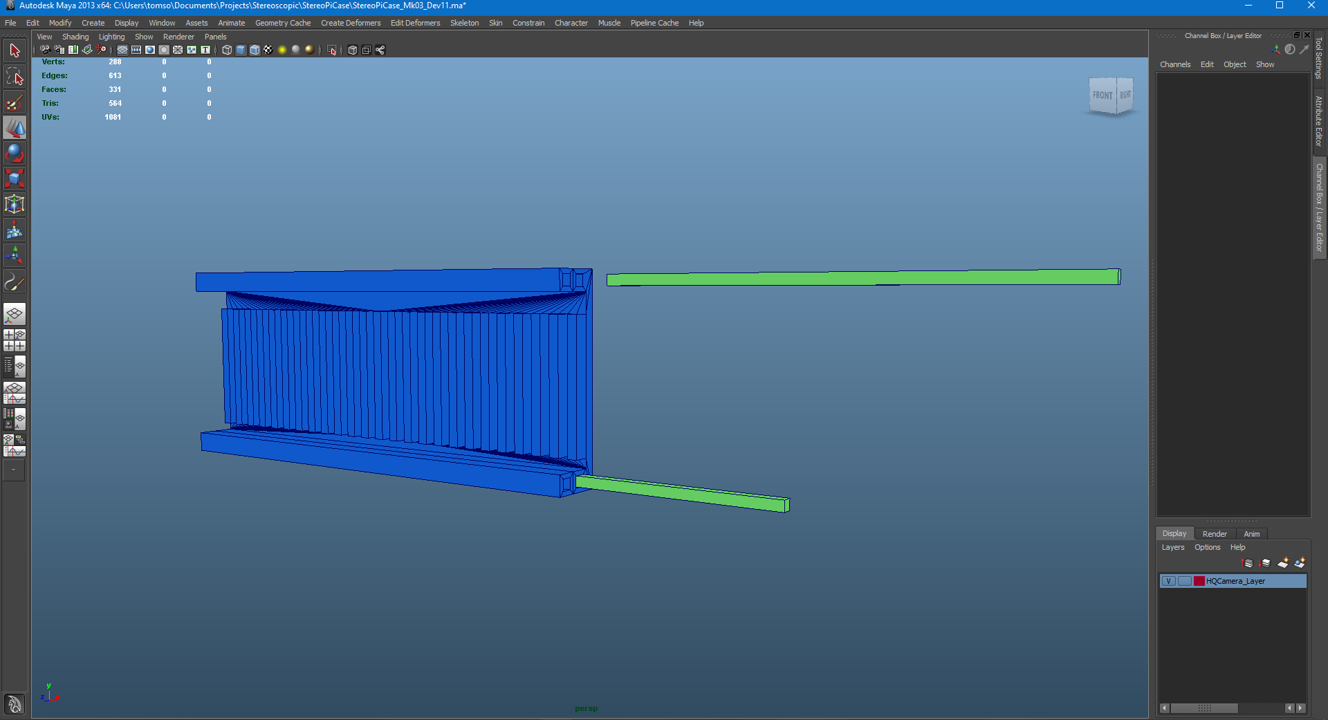

Yeah, the idea is that you can attach/detach any number of 'wings' using the green pegs as shown in the images. Each wing has two carry slots for the pegs, and two fit pegs slots. The carry slots allow the pegs to be more hidden when not in use, whereas the fit slots allow wings to be attached to the main camera body or more wings. Technically you could just keep on attaching wings, although it would get tricky to hold and balance after a while. I think there are camera ribbon cables four metres long, so you could have a stereobase of eight metres :D :D
I'll double check the forum post, but I think I may have already seen it. I will probably have more questions!
Yeah I'll be using a screen, a Waveshare 2 inch screen, the form factor is nice and slim and it can be connected to the GPIO! Can you use a mobile device's screen as a viewfinder? Even if there is no wifi or mobile data? I'm thinking about using this out and about away from home.
I have uploaded more images! :D

stereomaton wrote: Tue Jun 09, 2020 1:57 pm It looks nice with apparently a compartment for a battery and adjustable baseline.
Yeah, the baseline is adjustable, and the part where the StereoPi sits can be taken out for easy adjustments. The StereoPi slot also helps hold the battery in place. Still needs some work doing to make it better for use and to make sure the camera boxes stay in place properly. I may create a new type of wing or front, as I'm not sure the snap connector I've created will be sturdy enough.
I'll upload some photos and videos when I'm done making it and had it printed. I'm still attempting to figure out whether to use SLA printing for the case or get it laser cut from wood, then weatherproof the wood somehow (rubber seal/liquid/other).
As for sharing the case, not just yet. It's still not complete, but, if you ask nice, I might be persuaded to share it. Although I'd like to test it first and make sure it suits the purpose before distributing it. The case has my name embedded onto it also in the model, that would have to stay on for advertising purposes XD
