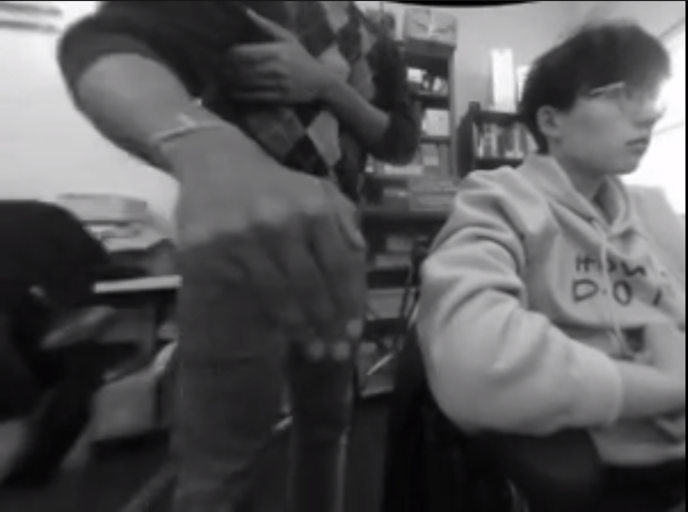

I'm attempting to create a disparity map with two fisheye cameras. We're running scripts from https://github.com/realizator/stereopi-fisheye-robot.

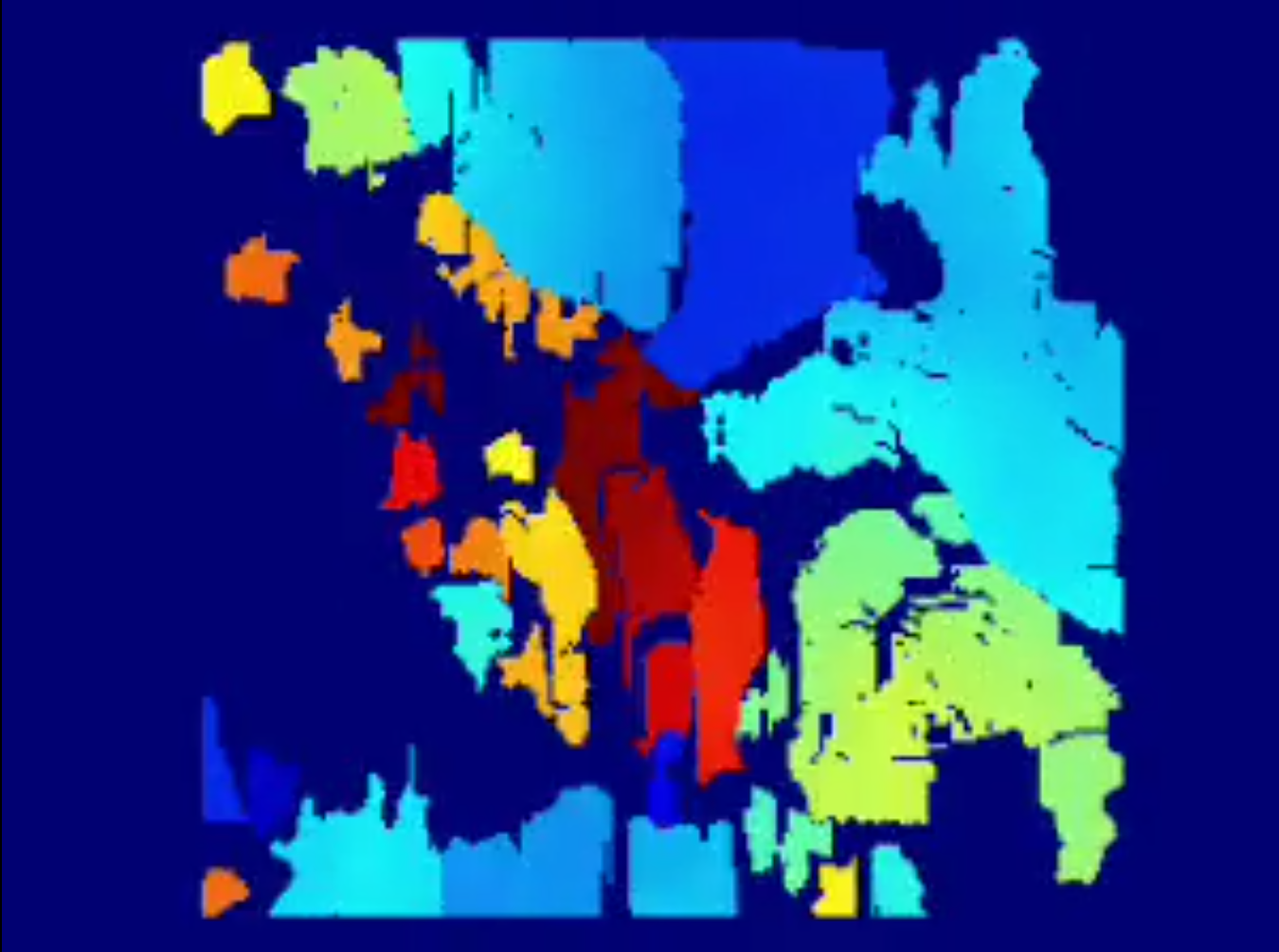

We ran the calibration successfully and tuned parameters exactly as shown in the videos. Regardless, we're having trouble achieving the same performance/smoothness/quality of the disparity map shown in the demo video. We've tried tuning parameters extensively and we've also taken a look at some of the other posts on this topic, but we still have an extremely noisy map (fluctuating colors, noisy/rough edges, lots of speckles and patches of random color).
Changing the minDisparity, numberOfDisparities, speckleRange, or speckleWindowSize seem to be helping, but it's quite difficult to pinpoint the exact parameter values for the best image. Is there any methodology or set process for finding the optimal parameter values (even programmatically)? Is there something beyond our parameter values that could be causing imperfection (lighting, our calibration, cameras)? Is there something in the calibration or disparity map code that could be changed to improve our map quality?
For reference, here's our fork of the repository that contains all of our calibration data, results, and settings (such as scenes, etc): https://github.com/vivvyk/stereopi-fisheye-robot. In the "vids" directory, you can see recorded videos of our disparity map. I've also included some screenshots here. As a side note, our saved video has slightly worse resolution but it's much clearer with the cameras.

1. If you look at your dm-tune.jpg, you can see that left part of your stereopair has some specific overlight on a light elements (lamp and window). Please clear optics on your left camera :-) This can affect on a small details detection.
2. You may notice, that your problems on a depth map appears on the very nearby objects (your hand near the camera). When the object is too close to the camera, it's positions on the left and right images are far away from each other. And if this horizontal difference is higher, than your NumOfDisparities, this object is "out of depth field of view", and StereoBM can not math it and get disparities.
By the way, if you run script 7, you can find that system will not show you red points closer than some specific distance. This 2D map can clarify for you, what is your StereoPi really see.
Also you may notice, that your dm-tune.jpg image has no any object close to the camera. A man on this image is more far away from the camera, than a hand on the photo from this post.
How to fix this:
- Before capture dm-tune.jpg, please put one object CLOSE to your camera at the distance, which you want to be the CLOSEST distance for detection. As a rule, it is 30-50 cm or more. If you put closest object at, say, 10 cm, you will have 2 problems. First one is a bad matching (as this object will be seen by cameras at the VERY different projections). The second one is a narrow FOV of your depth map (you can notice, that black fields on the left and right sides of your depth map depends on mindisp and numofdisp).
- After that tune your depth map the way, where this nearest object has a red color.
- After tuning this, tune mindisp to adjust far objects to have dark blue color.
- Please notice, that for tuning it is better to use textured objects with high contrast, but not uniform texture (like white t-shirt, walls etc).
