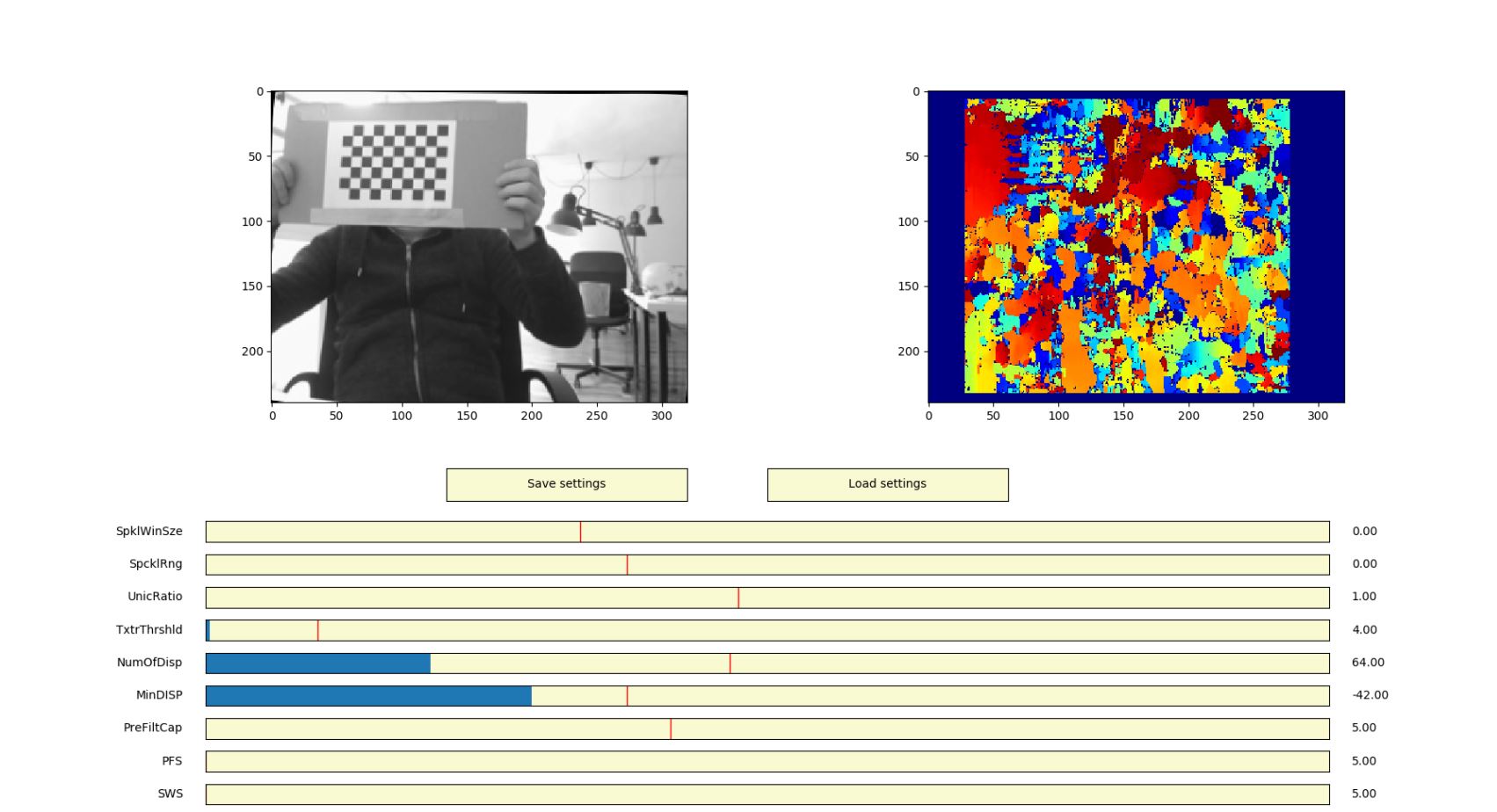

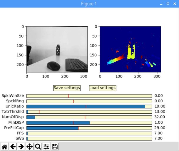

I've been trying to get the StereoPi to work for a while now, and I would appreciate some help.
I'm using two Raspberry Pi v1.3 cameras and the StereoPi v0.9 board. Also, lately I've been using the updated code from the fisheye repository.
The images taken with the 2_chess_cycle script are very promising. Almost none of them were bad in terms of colors/lines, but those that were have been removed. When calling 4_calibration_fisheye, I ran into some errors. After some googling I managed to fix them by removing some of the image pairs that apparently were considered "bad pairs" - the corresponding error messages were "CALIB_CHECK_COND - Ill-conditioned matrix for input array X" - indicating the picture that was flawed, and later "abs_max < threshold in function stereoCalibrate", with no hint as to which image pair might cause the issue.
I managed to identify the problematic pair, and the script finished without errors. I then moved on to script number 5, and unfortunately, this is as far as I got. The output of the depth map is really underwhelming, and while I managed to improve it slightly by adjusting the bars in the interface, it's a looong way from being good. I added the initial depth map as well as the one I managed to generate as attachments. As you can see, the bottle is detected somewhat, but other than that, it's pretty bad. My question is, how to optimize these results.
I appreciate any input!

According to your depth map on your first image, I see some "depth" inversion on your left edge of a table. Closest to the camera parts are blue, and far elements are red. This problem usually has 2 reasons:
1. Your left and right images are swapped. Please check you have the same camera capture settings for the calibration and for the capture.
2. You need to adjust MinDisp and NumOfDisp settings
If you can send me an archive with your images (ideally with the removed "bad" images) and a sample image, I will try to make an experiment and find other issues (if any). You can zip all files and put it somwhere in the cloud (Google drive etc.)
As for the bad images - I mentioned it in our last article.
By the way, your test image has a lot of white objects without textures (like wall and, partially, the table). These white zones are real problem for the depth map (not only for the StereoPi, but for a humans too

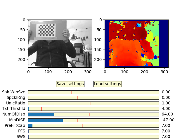

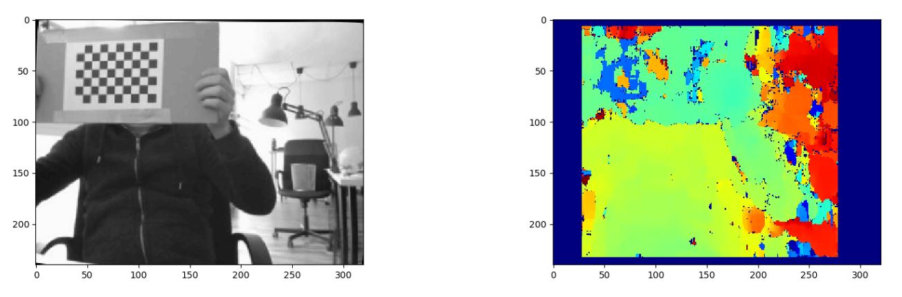

Ok, looks like I found a problem source.
To say briefly, you've taken calibration chessboard images with one camera setup, but image for your depth map with another setup. Under "setup" I mean the positions of the cameras with respect to each other on your camera mounting plate.
That's why it is recommended to fix cameras as robust as possible, because if you move one of them, you need to recalibrate your setup.
What am I did:
1. I did a calibration based on your images set
2. I used your image with the bottle and a keybiard for DM tune, But after calibration I noticed, that key points (like a top of the bottle) is not equalized horisontally.
3. So instead of your bottle-keyboard image I used one of your scenes photo for Depth Map calibration (resized it from 1280x480 to 640x240 before).
I used a "scenes" window on this screenshot as a ruler. You may compare the position of the bottle's cap on the left and right photos (left cap is higher), and the position of your hand on the chessboard photo (position on the right photo is higher).
So the idea is: fix cameras, so they can not move even slightly, after that do your calibration, and conduct your experiments. If you re-assemble your setup, or move one of your cameras, please do recalibration.
p.s. I decreased all DM settings to zero, except mindisp and numofdisp. THis helps to find appropriate settings faster. After that you can tune other parameters to get smoother DM.

Well, this is quite the improvement, thanks so much! I will try to replicate it on my end and will let you know, probably by tomorrow afternoon.

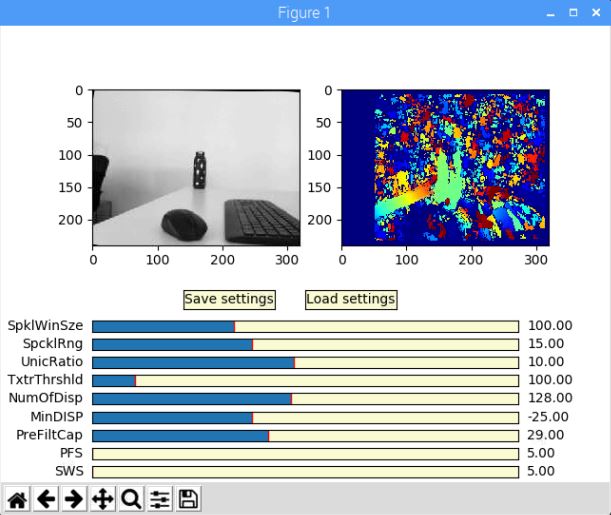

So, I made sure the cameras are tightly in place, and they are. I re-screwed everything, just to be sure.
The cameras used to be unstuck, but that was fixed a while ago, so now there's no way they are moving.
I ran the calibration again with the exact same images, resized the image you used for the DM tuning and ran that, but with the exact same settings you have, it doesn't achieve the same results.
Any ideas?
Any ideas?

Am I right understand you, that you just try to repeat my experiment without taking any new photos? You’re using the same images set you provide me with your Google Drive? It’s a good idea to do this before taking the new images.
If you do it this way, have you try to adjust mindisp and numofdisp slightly? They are very sensitive.
Upd> I’m out of my lab now. I can export my depth map settings and send you this file tomorrow.

Hi Bpe,
My 3dmap_set.txt and dm-tune.jpg are in attached ZIP. I used downscaled scene_1280x480_7.png file for making this dm-tune.jpg
