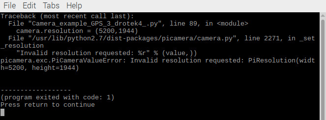

thanks for your prompt reply. I tried raspistill (e.g. raspistill -3d sbs -o "test.jpg" -w 5200) which works perfectly, however when it comes to Python, it blocks any attempt of increasing the width above the standard resolution
Maybe I am missing some specific tweak, but it seems as if it wouldn't work via the Picamera module.

Pascalfust, I confirm this problem. Looks like PiCamera has internal image size limits, and is not taking into account, that we need stereoscopic one (with the twice more width).
I've opened an issue at Github concerning this bug.

2. To fix an error from your screenshot, you need to do some changes in this file:
/usr/lib/python3/dist-packages/picamera/camera.py
You need root level to edit it, so I just run:
sudo thonny
to open editor with the super user privileges.
Go to the row 2271, mentioned in your error, and add '*2' at the end of expression. So you have:
(0 < value.width <= self.MAX_RESOLUTION.width*2) and
Do not forget to set "stereo_decimate=False" in your PiCamera settings.
I've attached both files (edited camera.py and my test Python code I used to capture image). Could you please check, if it works for you?
