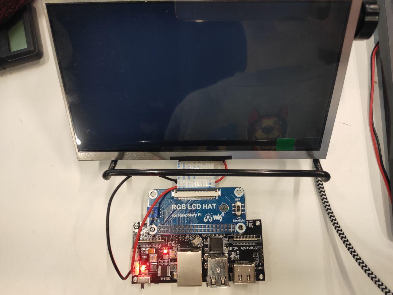

Hi, I'm trying to connect this screen to stereopi with compute module 3, but all a got so far is black screen with backlit on.
Like this:
Running on raspbian buster. I2C and SPI enabled and here's my config:
