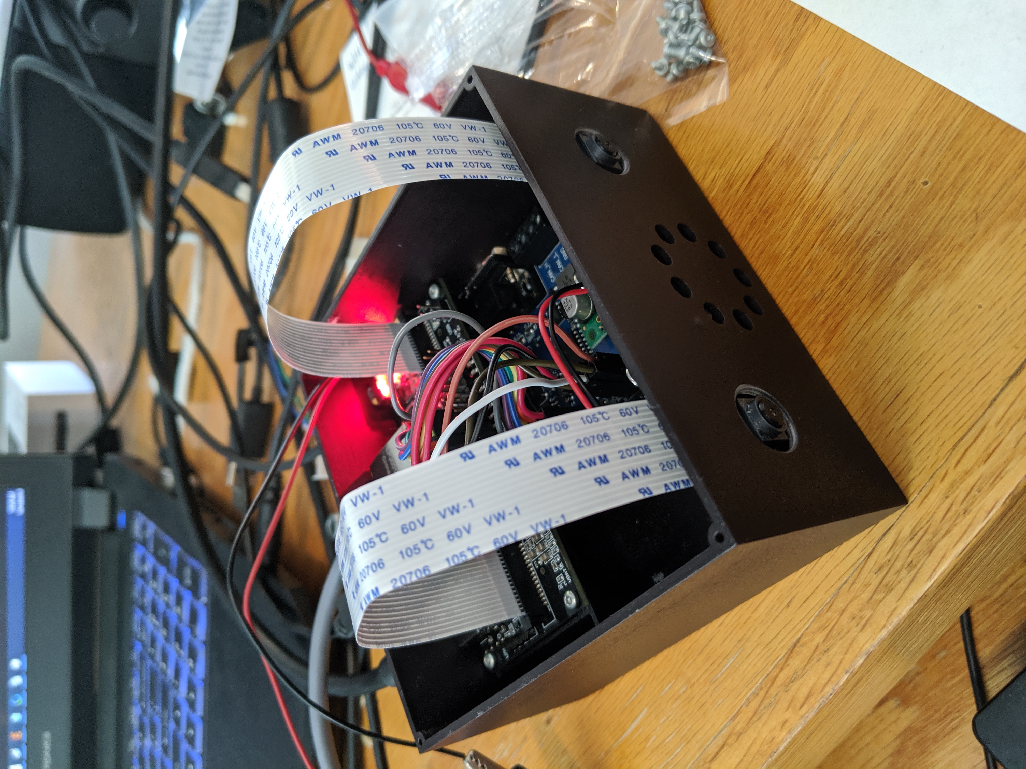

Is it possible to rotate the video 180 degrees? The way I had to mount the cameras in my case has the image upside down.

Any suggestions on how to rotate the image 180 degrees? Here's a picture of how they are mounted. The connector on each camera is on the top. It seemed like the most natural way to mount it but it made all the scripts show up upside down.

Re: rotate video 180 degrees?
As you mentioned 6 scripts, I can suggest you're using a code from this repo: https://github.com/realizator/stereopi-tutorial
If you look inside the first script, you can find this row:
This option do horizontal flip for each image.
You can also use another option:
This will flip image vertically.
I flipped the case upside down, removed the rotation = 180 code and ran through everything again. On the calibration step the final two calibrated images look fish eye (this is a V2.1 Raspberry Pi Cam, no fish eye).
