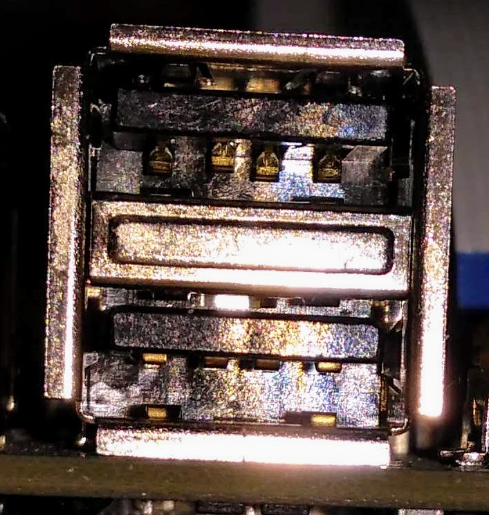

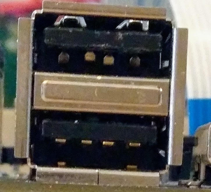

Could you please make a photo of your USB connectors? You can attach it here to your post, or send me by email to @gmail.com, with my nickname on this forum before '@' sign.

Hi, USB 1 is a normal photo and USB 2 is taken with a flash to try and get more detail. Due to having to take a larger area to maintain focus and subsiquent cropping this is as good as it gets unfortunately.
USB 2.jpg (161.78 KiB) Viewed 11515 times
USB 1.jpg (120.11 KiB) Viewed 11515 times

Codfangler, thank you very much!
Now I understand your situation. I think it is a USB connector problem, as their contact pins inside should not be damaged by any USB device, as in your case. May be bottom connector is still Ok and you can use it before replacement board arrives.
