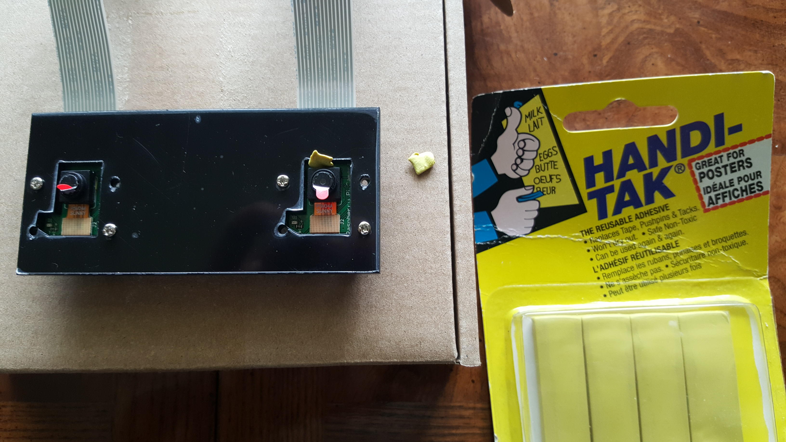

I am not from StereoPi, but I noticed a white removable piece of tape that would allow you to firmly fix the camera in place once removed. It was at the back of the lens. Instead of firmly planting them, and to allow for future alignment adjustments I used some handy tack to seat the lenses. A partially inserted piece of handy tack is shown in the picture and another is ready for the other lens.

Blinky wrote: Mon May 13, 2019 6:56 pm I am not from StereoPi, but I noticed a white removable piece of tape that would allow you to firmly fix the camera in place once removed. It was at the back of the lens. Instead of firmly planting them, and to allow for future alignment adjustments I used some handy tack to seat the lenses. A partially inserted piece of handy tack is shown in the picture and another is ready for the other lens.
Regards,
Blinky
Blinky, thank you for your answer and help! :-)
By the way, I mentioned on your photo, that you did not removed safety film from your camera mount plate. I'm just a curious, is this your special approach (and you want to safe glossy surface), or you did not noticed that?

Regarding the protective film, I may in the future cut the mount in half and then attach the halves on something to mimic focusing eye movements. It is easier to protect the finish with the film.
