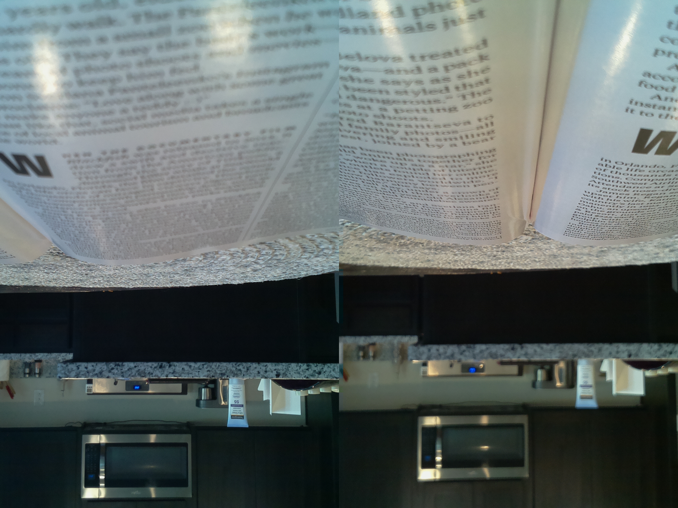

Just picked up my stereopi deluxe kit. I assembled the waveshare 160 degree cameras onto the board to test and found significant artefacts in one of the lenses. I have attached a photo, there are three circled all together
artefacts circled in yellow
After seeing this, I removed the lense from the camera and found that the sensor has some kind of substance on it that I assume is glue, likely from when the lense has been attached.
Whats the best course of action to take?
Re: waveshare camera
Posted: Thu May 02, 2019 7:29 pm
by Mr-Qu33f
on closer inspection, it seems that the sensor itself is cracked. I've sourced a replacement which should arrive saturday hopefully
