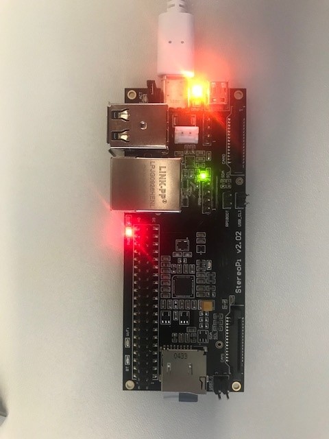

It is orientated as shown in the manual and I felt the two "clicks" while mounting.
The "green" SD card is inserted. For testing everthing is removed except the USB-C power supply. (Power jumper is set)
Source Ind. LED shines red
Power ON LED shines red
The green LED nearby the Ethernet Connector shines red
But:
The Act LED remains dark as well as any other LED
A monitor connected to the HDMI connector before power up remains dark
So I think the CM4Lite modul doesn't boot.
Does anybody know what may be wrong? is the CM4Lite defect?

Please check that RPIBOOT and USB_CLI jumpers are not installed.

They are not set.
Only the power jumper is set

Two pictures
Posts: 940
Re: CM4lite modul doesn't boot.
Your setup looks correct to me.
