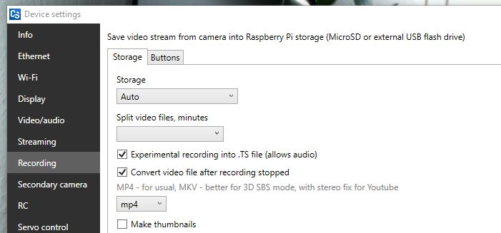

My guess is that it is less due to the camera settings and more to the device settings under Recording. After deactivating the checkboxes there, it worked again. Currently only TS file recording does not work anymore. When I activate this checkbox, the camera does not record any video. Before that, I was able to record with TS, but the sound was poor.

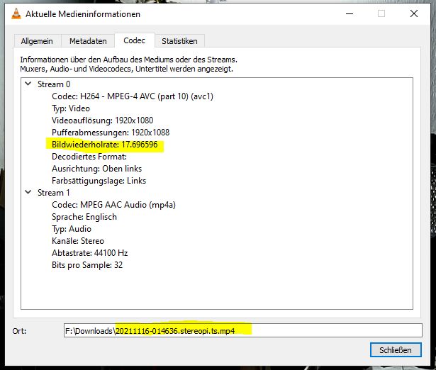

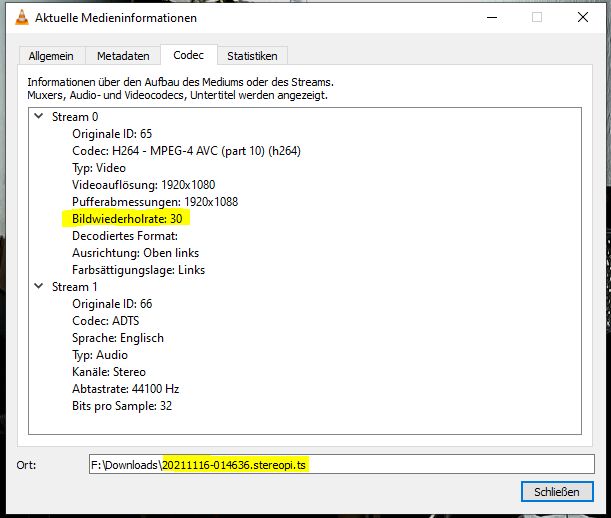

could the problem possibly lie with the conversion of ts to mp4 file?
