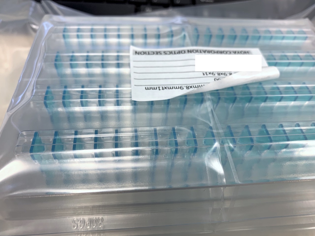

Wow... I never saw the CM500 filters in the condition of items that are on the left side of your photo...
We got CM500 filters directly from the HOYA company (Japan), and they are packed in trays (look at the photo).
I can't remember any films or other items attached. They should look like polished, mirror-like glass.
Also, I'm curious about the strange signs on them (like a square with rounded corners).
Have they arrived in this condition with the kit?
