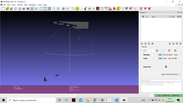

I have a program that allows me to find the disparity map with 2 images from two non-stereocalibrated cameras. The disparity map looks good but when I add a piece of program to get a 3D map via meshlab, I get some scattered points (see photo result_clou.png)

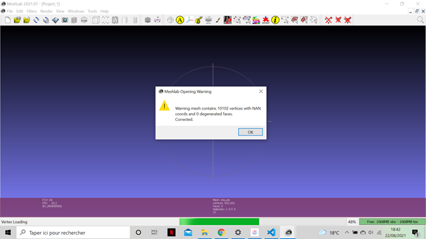

On the other topics, I saw that I had to change the type and divide the disparity map by 16. I tried with a new map called disparity_SGBM2 as follows: disparity_SGBM2 = disparity_SGBM.astype(np.float32) / 16.0
I took a screenshot of the .ply with his error message (see result_disparity_SGBM2.png)
Does anyone have an idea how to unblock me please?

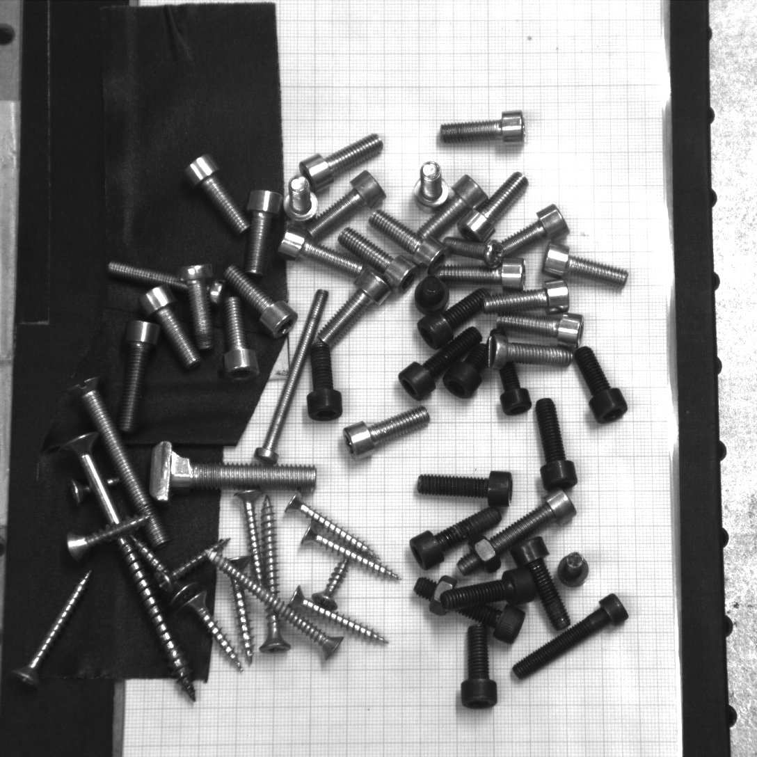

I also joined my python program below (because I can't send a python file) and the images used with the program (clou-l.png and clou-r.png).
