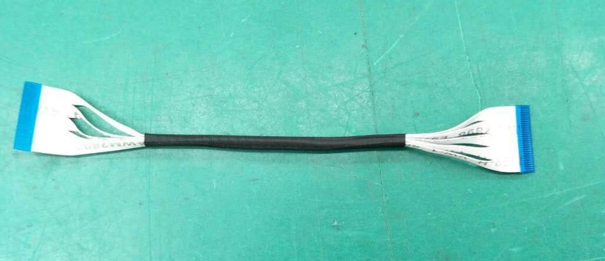

As for the round cables - we try to find the Pi-compatible cable like this, but no luck...
The only similar cable we were able to find is this one (see attached photo). Please note, that on the photo it's not 15-pin cable as needed for RPi, but we have 15pin version on hands.
This cable is not as flexible as expected. We're in a process of our search...
tubed cable
tubed cable
