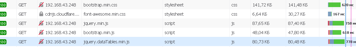

I noticed that when page loads tons of time taken by loading images ) :
So to speed up i just pass them through optimisator and result became:
So to do so u just need to upload optimized images and replace old ones. It can be tricky as there`s no VNC.
I recommend ftp. For example - https://www.xlightftpd.com/
After that u can upload them this way:
New images -
new_images.zip
(145.39 KiB) Downloaded 2068 times
Next i`ll look after js may be it can be optimized too.

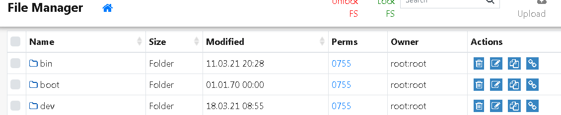

Additional optimisation.
Web file-manager.
Web-page time load before:
After optimisation:
What have done ?
All external links of js and css put to filesystem (most of all).
To do that you need put updated index.php to /var/www/html/files
And js and css after unpack to /var/www/html/files/js
Files -
js.rar
(239.72 KiB) Downloaded 2064 times
and
index.php.rar
(28.3 KiB) Downloaded 2062 times
