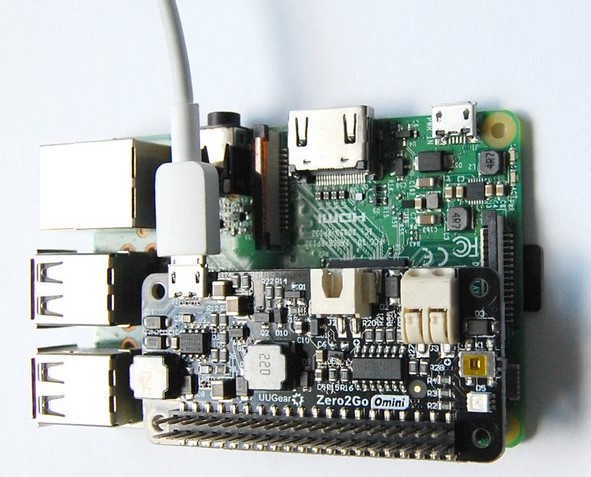

I was making a case to stereopi and got ready to put on new hat for it -
zero2go omni -http://www.uugear.com/product/zero2go-o ... pberry-pi/
It`s very convinient as one can power pi from different sources, correct shutdown and etc.

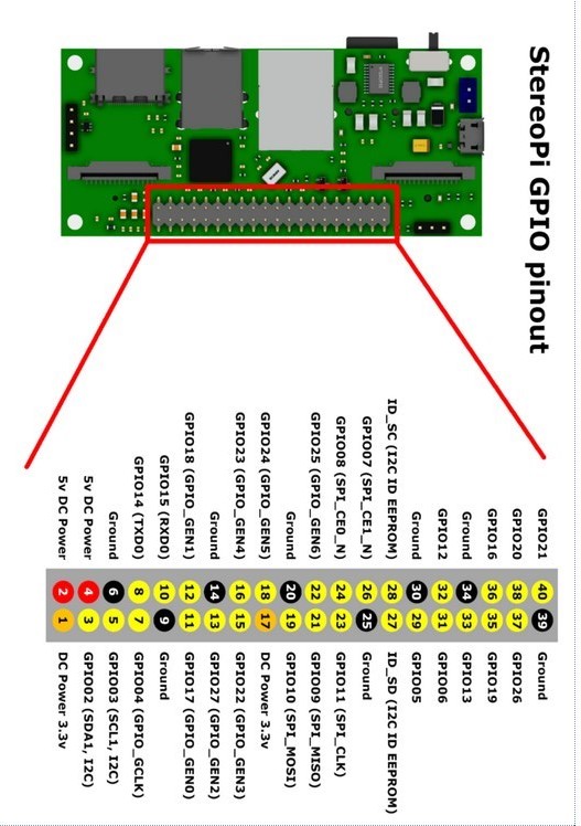

But i found out that GPIO header of stereopi is reverced !

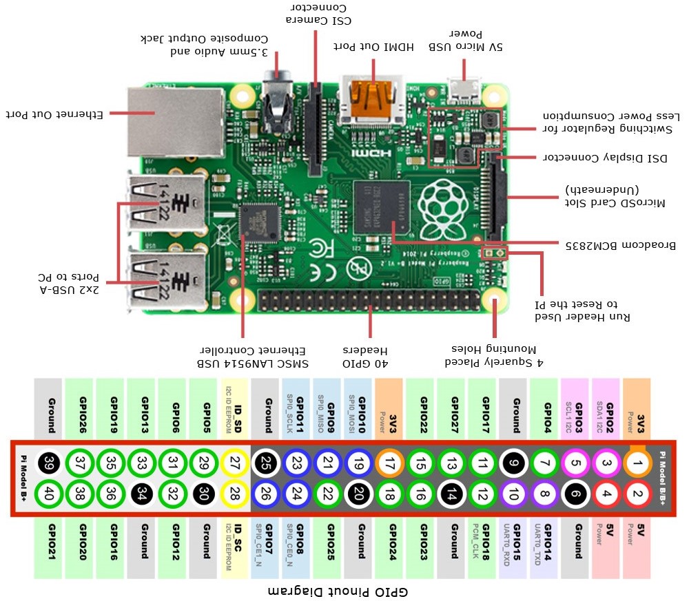

While the standard GPIO header looks like this -
So i couldnt place a hat standard way -
I put it reverced ! Facepalm. :shock:
It working but now i can forget about cosy case ((
Pi-hat i connected is sticking out...

If the GPIO connector was the way around, the pi-hat would cover the camera connectors.
Since the cameras are primary functions with this board, it is probably better this way.

Re: stereopi hats wtf ?
@zoldaten JFYI, we fixed the GPIO position in the new board. As for the tall header mentioned - yep, this might be an option.
