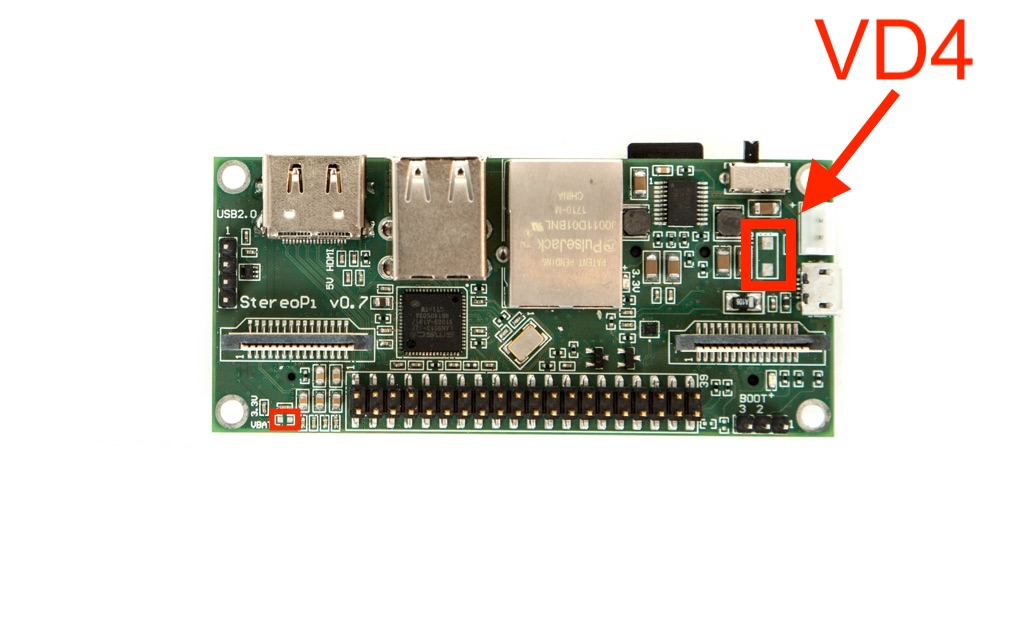

Hello MORagab,
Wow, your result is very interesting! In our stress-tests StereoPi was able to alive up to 83 celsius (where the CM3+ throttling usually begins).
Could you please share your enclosure design? I'm curious, what causing this thermal problem in your case.
What' going on under the hood:
1. StereoPi has a USB switch logic, which works when you connect it using a micro USB connector. In this case, onboard USB hub (LAN9513, which hosts both USB and Ethernet), is disconnected, and CM3's USB is commutated directly to the micro USB connector. Looks like in your case this logic starts working when it shouldn't.
2. While our early stress tests, we found one component, which was the most temperature-sensitive. It is diode Schottky, or VD4 in our schematic, power part. This diode sits right in a critical place. If it is overheated, the USB hub is disconnected, and you are losing USBs and Ethernet.
3. If you will take a look at the very first StereoPi edition photo in our Wiki, you will find this VD4 is not soldered. I'm attaching this photo with the highlighted mount place. After our tests, we chose another version of this diode (more robust) but looks like in your special case it cause this problem.
How to solve this issue:
You can unsolder this component. After that everything will work as intended, except advanced micro USB features (like eMMC upload, USB gadget mode, etc.) If you are not using hidden micro USB features, this will not affect your device functions.
MORagab, if your StereoPi die while soldering, we'll send you a replacement. You are the first person who faced this issue, and we are curious to dig this out and help you!
VD4 mounting place
VD4 mounting place
