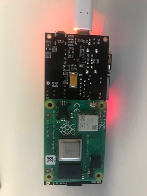

It is orientated as shown in the manual and I felt the two "clicks" while mounting.
The "green" SD card is inserted. For testing everthing is removed except the USB-C power supply. (Power jumper is set)
Source Ind. LED shines red
Power ON LED shines red
The green LED nearby the Ethernet Connector shines red
But:
The Act LED remains dark as well as any other LED
A monitor connected to the HDMI connector before power up remains dark
So I think the CM4Lite modul doesn't boot.
Does anybody know what may be wrong? is the CM4Lite defect?

Post by RainerMohrlok »
Two pictures
Re: CM4lite modul doesn't boot.
Your setup looks correct to me.
Is this state stays the same with both micro SD cards from the kit? Coud you please try to boot it with another card. This might be the micro SD imaging process issue (on the factory).

I checked the voltages on the CM4Lite, they are ok?
Is there something with the card reader?
Btw. while powering up the Act. LED flashes once for a couple of milliseconds

I checked the voltages with the scope. They look ok.
But nowhere I saw something like a tact signal?
I wrote you an email.
With a new CM4Lite:
It works!!
How to change/repair the defekt CM4Lite?
