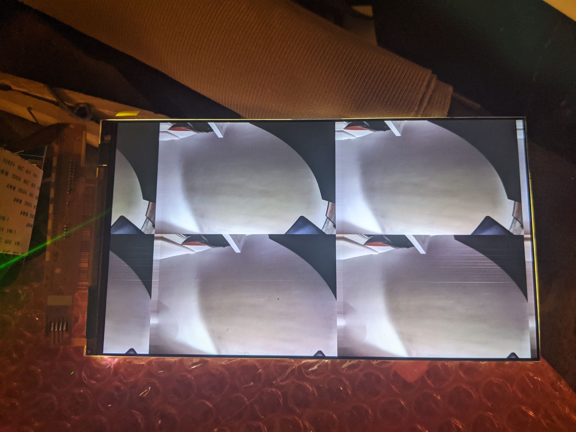

I've plugged my SLP2 card into my StereoPi2, and used the web admin to configure the board to output a video stream of HDMI 1920x1080@60p (CEA 16:9 mode 16)
The display I'm using is a 2560x1440 screen sourced off of Amazon: https://www.amazon.com/gp/product/B0826YHTLM
The problem that I am having is that the stream from the pi is being rotated 90 degrees from the screen orientation, then stacked and output twice and two fractional times on the screen:
photo of screen showing video stream from pi: A thin sliver of the stream is shown atop two copies of the stream, then another sliver of the stream. The horizontal rectangles of the stream are stacked along the long axis of the screen.
Is there a way to get the StereoPi to output a 2560x1440 stream, or to pass additional information to the screen regarding how the video should be rotated and scaled?
Re: Customization of HDMI output modes on SLP image
Hi glowingskull,
Wow, you have a tricky task.
To say briefly, not all HDMI screens are supported by Raspberry Pi OS out-of-the-box. In some cases, you should manually set the correct scxreen resolution and mode inside the config.txt file. You can take a look at the official documentation from Raspberry Pi Foundation.
Most HDMI screens for Raspberry Pi have a list of settings to put in this configuration file. For example, we got a similar issue with the 90-degree rotated image and settings for the 5" AMOLED screen. You can find the details in this article on our blog.
To fix your issue, you need the setting for the Raspberry Pi. It does not matter which board you are using - Raspberry Pi 4 or StereoPi with CM4. They have the same settings.
p.s. I see some strange note in your screen description on Amazon: "Only Support Dedicated video card, need GTX960 Graphics"... We decided to keep the current design as-is for this batch.
