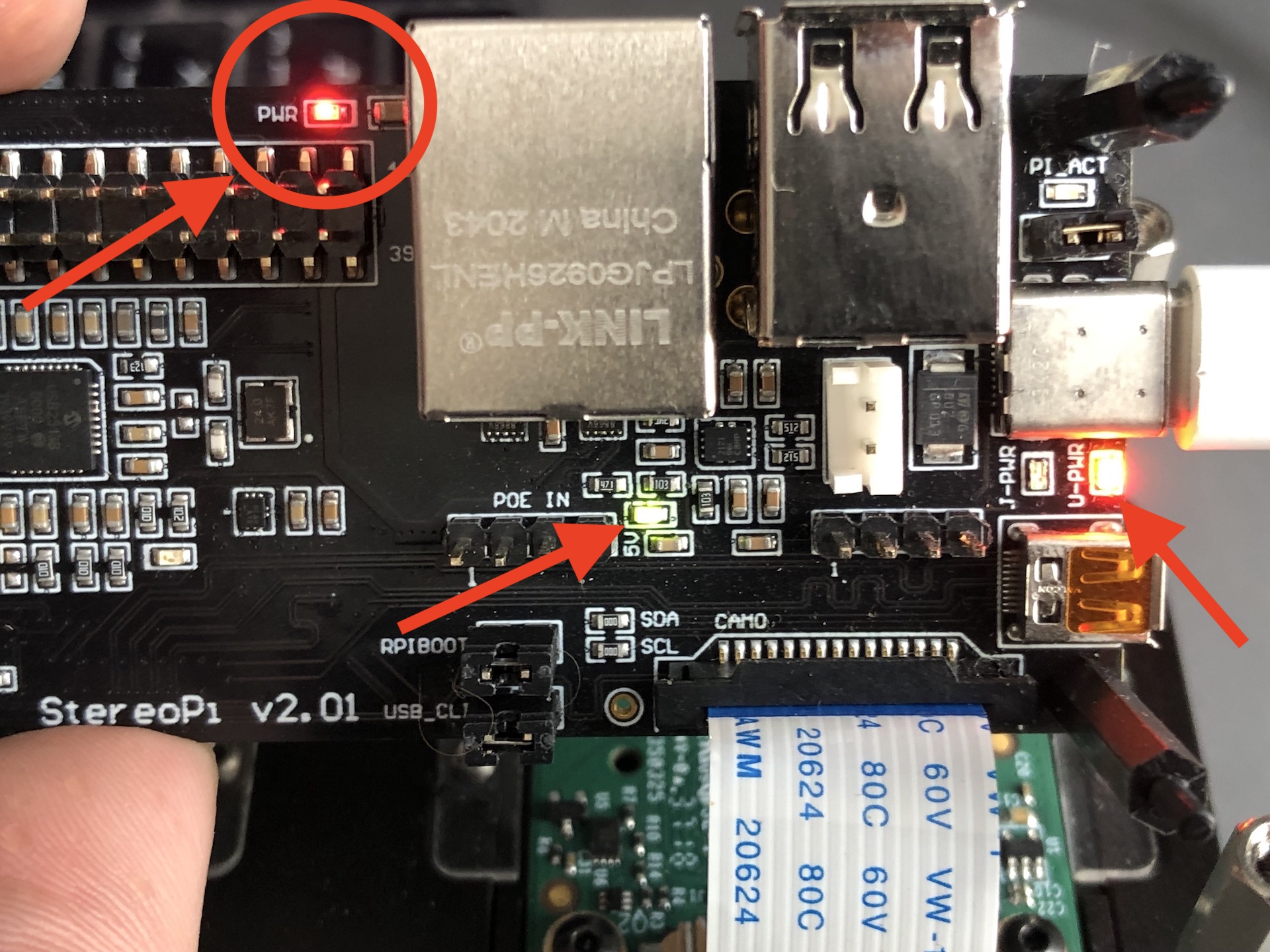

1. When you connect the USB C cable without the compute module attached, two LEDs on your StereoPi v2 should light up:
If you see only one LED (U-PWR near the USB C port), it means the board "feels" the power, but is not turned on. Please check your "switch" jumper is inserted (near the PI_ACT LED).
2. When you connect the USB C with CM4 inserted you should see one more active LED, which is "PWR". This means your board is powered on now and will either boot (if no RPIBOOT and USB_CLI jumpers attached), or go to the "mass-storage" mode for the eMMC upload.
Here is the photo of the board with all LEDs active:
I'm using Mac too. You are right - for the eMMC upload you need to use the USB C cable only.
Let's check two things:
- with_cm4_noted.jpg (783.99 KiB) Viewed 11167 times

Bingo! I didn't have the jumper connected to the jumper next to the PI_ACT LED. Once I did this, my Mac recognized the BCM2711 in the USB tree.
