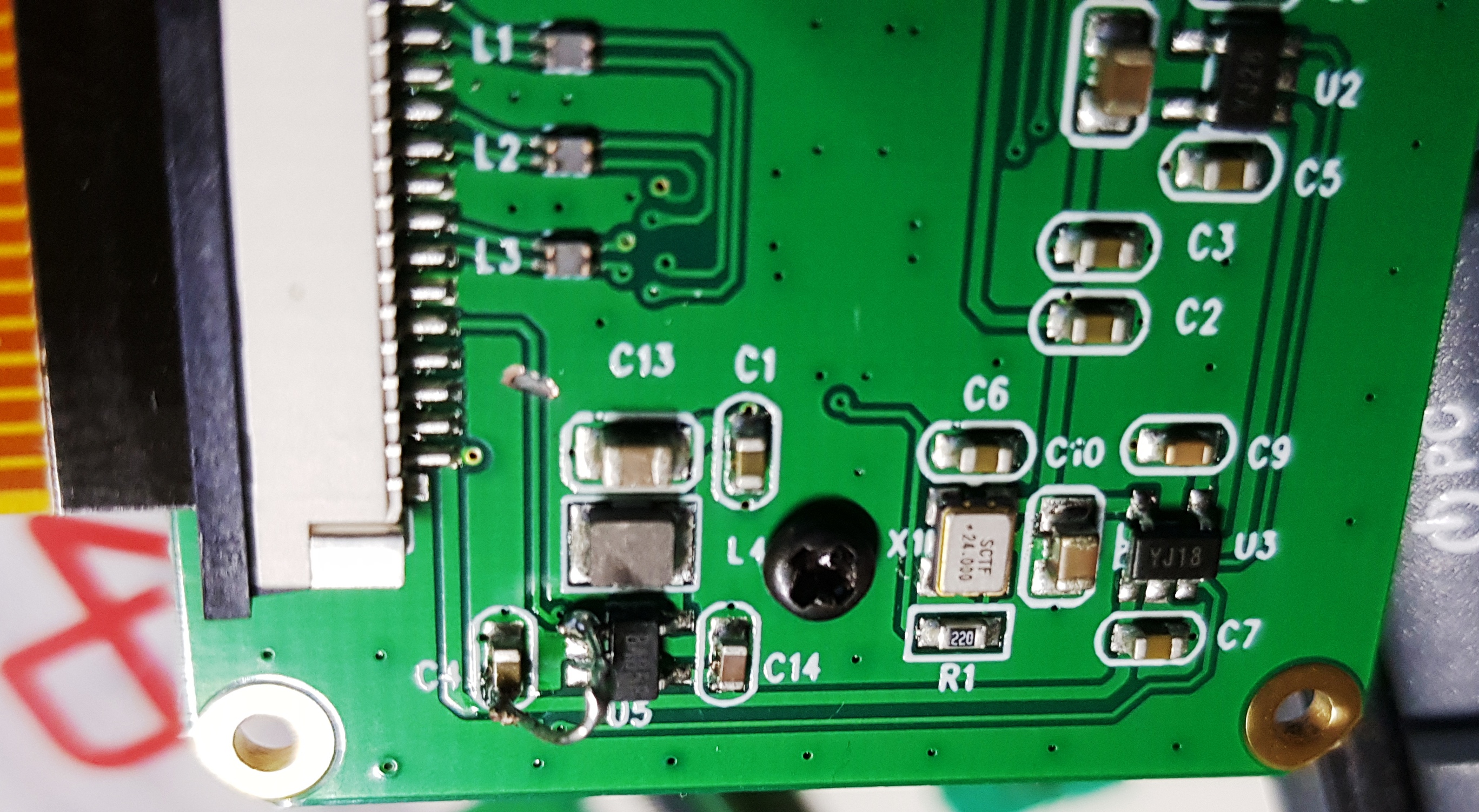

I think I identified the problem: it comes from the "CAM-GPIO" signal. This is common to the 2 cameras and controls the power supply to the cameras.
The "Raspistill -csX" command only activates this signal for one of the 2 cameras, which is abnormal.
The reason is that the Raspberry detects only one at startup. This shouldn't be the case with my "dt-blob.dts" file.
I then checked the I2C lines of the 2 cameras: they indeed contain the identification frames of the cameras: BUT ONLY ONE IS POWERED !!!
I tried to find information to drive the "CAM_GPIO" signal, without success.
I then used an electronic technician's solution (which I am ...): scraping a track and soldering a bridge! View the photo.

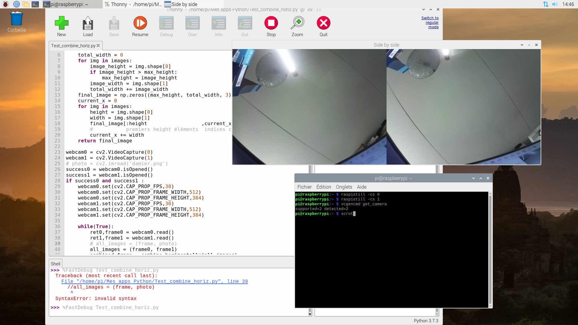

Now the 2 cameras are operational. View the photo

- Screen copy with the 2 camera activ
- 2021-05-07-144648_1920x1080_scrot.png (1.07 MiB) Viewed 80261 times

Well, the brutlal force usually works, but this is the brutal force
You see, when pins are not assigned correctly, the system is not able to do a camera reset and other options needed for the appropriate function.
