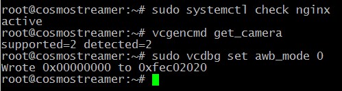

I`ve uploaded to CM3 stereopi SLP2 but have blank screen with only GUI-
I ckecked cameras presented and server working connected by SSH to stereopi -
And i couldn`t start up AP ( May be something here should be done -
Where to find what means what ?
Thanks for patience.
zoldaten
Posts: 48
Joined: Fri Apr 26, 2019 7:07 am
Re: SLP2 discussion
Post by zoldaten »
ok. got it working. just needed to set up camera settings in options menu.
