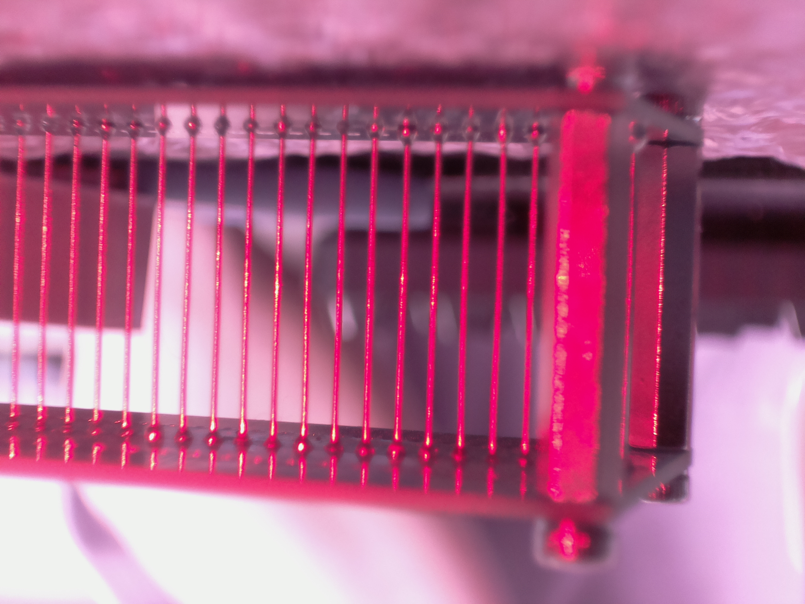

I am using the StereoPi to detect bright spots where the light from a multi LED flash reflects particularly intensely from the curved shiny surfaces, at the moment I am using an array of evenly spaced sewing pins (please see the image attached). Both of the cameras on the stereoPi are spaced approximately 150 mm apart and angled inwards at some angle so that their image centres cross approximately 200 mm away.
For each capture cycle I take two exposures, the first with the LEDs on and the second with the LEDs off. The reason for this is that I subtract the off image from the on image to reduce noise and make an image in which the bright reflections of the LEDs on the sewing pins are the only prominent feature remaining in the image.
My analysis is fairly lightweight, I take a horizontal intensity strip from the centre of the image (i.e. for a 1280 x 720 capture I take a 1280 x 1 strip from the 360th row). I then run a simple scipy.find_peaks() on the intensity strip and plot the data. This process is looped and the graph is refreshed for every capture.
1. I have a preference for resolution over frame rate as this is my limiting factor for the precision of the final measurement. I would like to ideally aim for an image with a horizontal resolution of 1500 and perhaps 5-10 full capture cycles (10-20 exposures) per second if possible.
2. I have tried my python code with and without the analysis and plotting operations and have found that they are fairly negligible with respect to the time it takes to simply call the camera.capture(output, 'yuv') command. I am therefore fairly confident that my analysis can deal with a much faster capture rate.
3. Real time processing is my aim as although sensor will only take measurements of stationary objects it will need to be finely positioned by hand when it is fully housed, a reasonable capture rate makes this process considerably easier. As above 5 full cycles (10 exposures) a second would be more than enough, anything beyond this would be considered a bonus.
