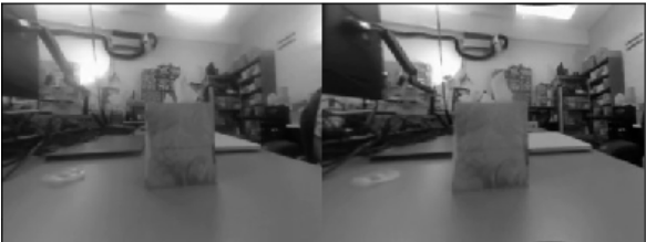

Here are two frames from our video of a tissue box:

The tissue box is 200mm away. We're guessing that the third value is (Z/W) is what we need but we aren't sure of the units. We read somewhere that the disparity map returned by opencv is scaled by 16, and we've made the assumption that the returned units are cm. This gives us 1.1743402 * 16 * 10 = about 192mm, which is our best result thus far.
We aren't sure if this is the correct approach. We've struggled to find documentation or the correct way to do this. We'd appreciate any input on how to correctly calculate distance, or any other feedback on our approach thus far.
