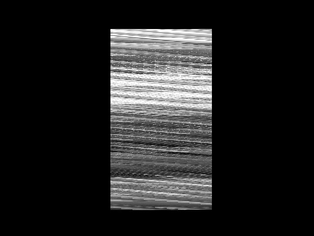

First outputting the Y data from the YUV data into an array of the same resolution:
import time
import picamera
import picamera.array
import numpy as np
with picamera.PiCamera() as camera:
    camera.resolution = (100, 100)
    time.sleep(2)
    y_data = np.empty((112, 128), dtype=np.uint8)
    try:
        camera.capture(y_data, 'yuv')
    except IOError:
        pass
    y_data = y_data[:100, :100]
    # y_data now contains the Y-plane only
Unfortunately the image produced from this is not as I would expect, clearly something has gone very wrong. Image attached.

2. Actually, your YUV output is not broken, but just have a horizontal "shift" for each row. You set 100x100 resolution, but actually low-level capture part has some resolution requirements (like width is dividable by 32 and height by 16). When you use an "easy" capture, PiCamera will actually scale image to your resolution, if it not fits internal rules. But with the YUV you need to keep follow these requirements, as it is low-level access.
