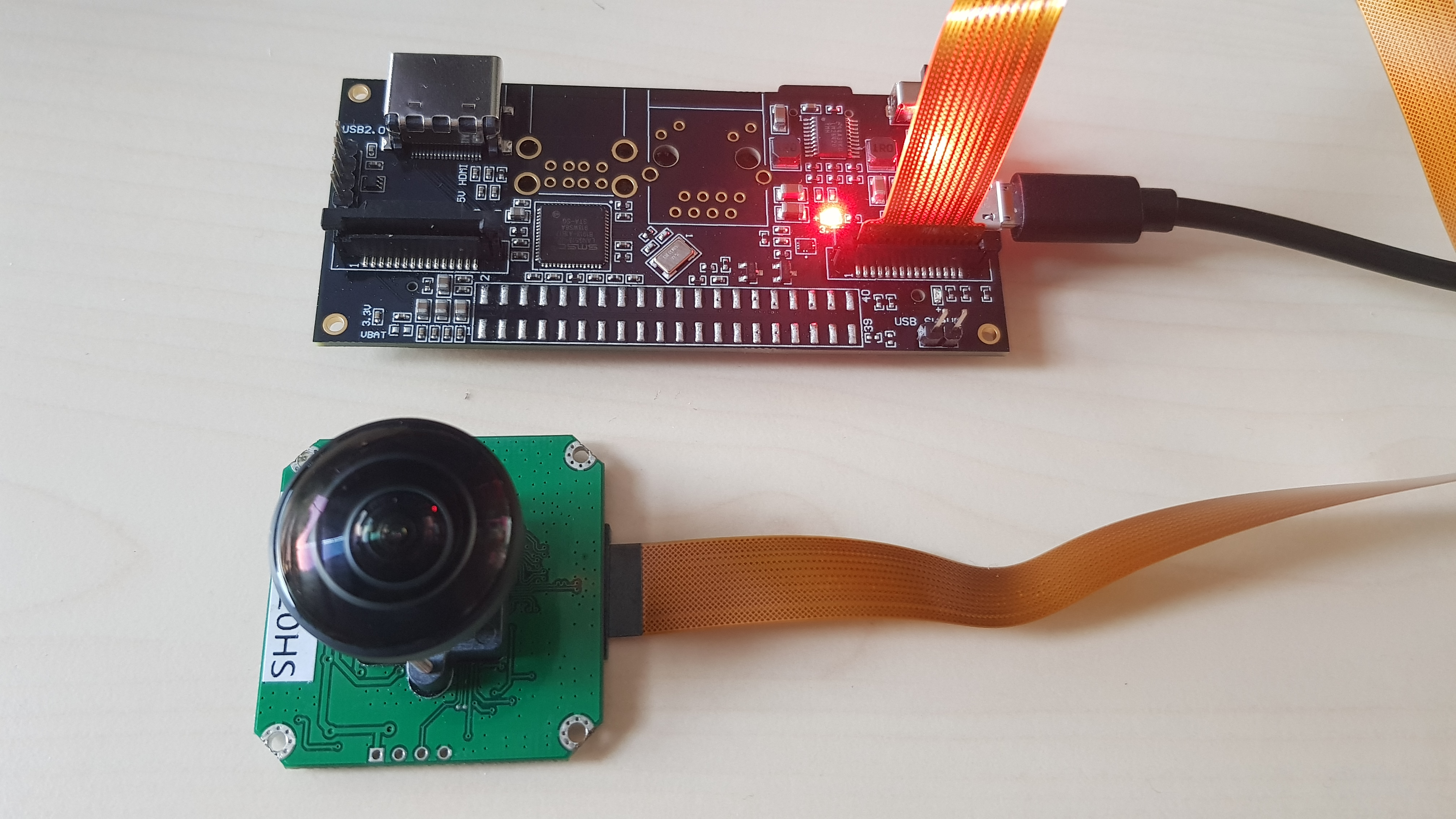

I'm currently trying to get an 18MP Arducam (UC-549, AR1820) working with the StereoPi Board. I installed all Arducam drivers and tried both camera connectors but none of them seems to work. None of the sample programs can connect to the camera. I even tried it with and without the dt_blob.bin in the boot partition but nothing changed.
I connected this camera to a Raspberry Pi Zero before, where all Arducam drivers were installed and this worked for me. So is there anything different to the CSI port on the StereoPi than on the Pi Zero?
Because the cameras communicate over i2c I checked the connection with "i2cdetect -y 0". The Pi Zero is successfully displaying the I2C-Adress (0x37) and I can read out the registers. But on the StereoPi there is nothing.
Has anybody maybe tried to get an Arducam running with the StereoPi? Do I need to configure anything else?
Arducam connected to StereoPi

I looked at this module's description (by following your link). But all the docs tells me, that it uses 22 pin cable, but not 15 pin cable like Pi cameras. But on your photo I see 15 pins cable. Are you using some adapter/converter 22->15 pin?
Could you please give me a link to the docs for the module you use. I will look inside the configuration specific.

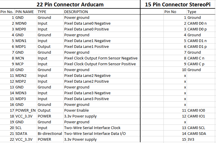

I also compared the pin-out from my Arducam with the pin-out from the StereoPi schematic:
Except the data lane 2 and 3 everything matches. But this two lanes are not required, because MIPI-CSI can also work with only 2 lanes (0 and 1). Even the raspberry pi zero is missing lane 2 and 3(see Raspberry Pi Zero schematic) on its connector (and with the zero, the camera worked). So the cable should perform well.
