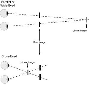

What you are not getting is that the two different modes of viewing put the images in the center of vision on different eyes.
When you freeview, the left image is seen by the left eye and the right image by the right eye. You do this by avoiding the normal convergence of eyes to an object at a distance, and looking straight ahead with each eye - the path between eyes and images being parallel, or at least less converged as in the attached diagram.
When I freeview, I cross my eyes and accentuate the normal convergence, with the result that I concentrate on the left image with my right eye and vice versa.
rather accentuated, this is what you you have to do to do either of the freeviewing techniques!

Considering parallel viewing : personally I can not actually diverge my eyes, I understand that most people cannot do this. This implies that the far points in a parallel stereopair for most people can not be further separated than the distance between their eyes, for adults some 6 cm. This limits the size of a P-viewable stereopair to 2 times 6 cm.
A lot of people experience a Cross-eyed viewed image as closer by and smaller than a Parallel-eyed viewed image. This is no surprise if we see the lines of sight in the image Gtol included. But I found that this difference is not noticed by all viewers.
