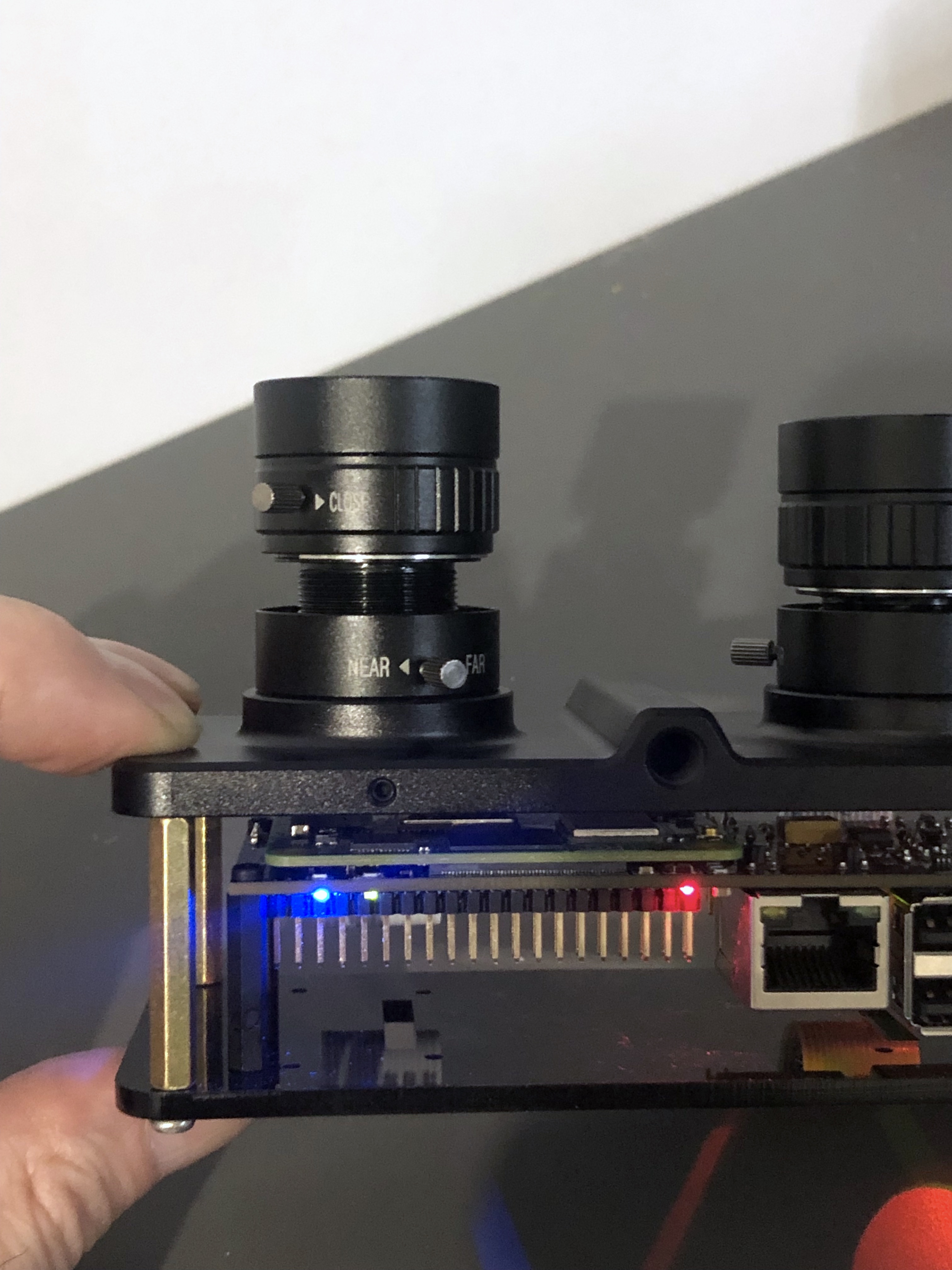

Eugene, every time I look at those pictures (and my 6mm lenses do the same thing of course) it seems totally wrong to me to have to unscrew the lens like that simply to achieve the infinity position (and farther still to focus on anything closer).<br><br>On mine, it looked like it was open about 5mm so I tried a 5mm C/CS adapter but that was too much. (Also the 6mm lens doesn't screw fully home in the adapter because of the step in the adapter bore).<br><br>I do have some 1mm and 2mm adjustment rings on the way but since they are rings, they will take up thread length on the lens and may be impractical.<br><br>As far as I can see, a better way to do it would be to shorten the height of the bosses on the lens mounting plate. Is it possible to buy the mounting plate(s) separately?<p>Statistics: Posted by <a href="https://forum.stereopi.com/memberlist.php?mode=viewprofile&amp;u=1002">dnaman</a> — Wed Jan 12, 2022 10:38 pm</p><hr />

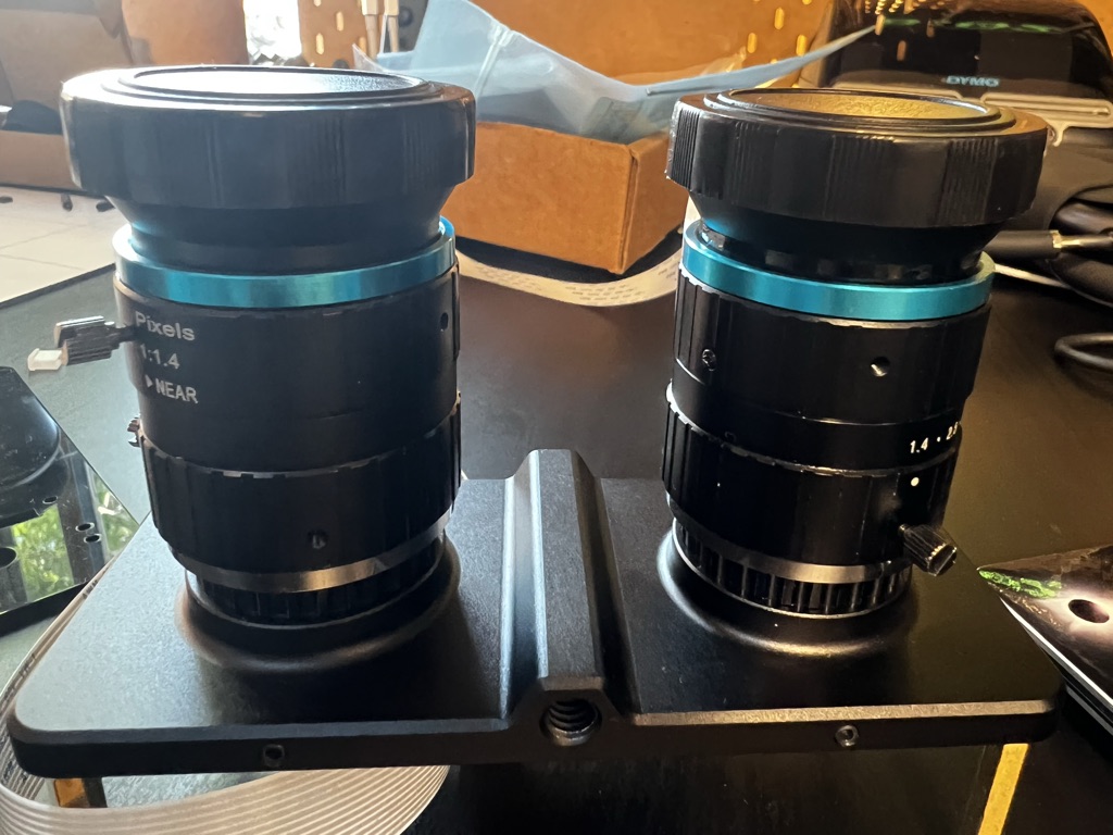

p.s. Here is the photo which can clarify the 6mm lens adjustment margin. This feature in not obvious from the official datasheet for this lens. Look at the left lens here:<br> <div class="inline-attachment"><dl class="file"><dt class="attach-image"><img src="https://forum.stereopi.com/download/file.php?id=240" class="postimage" alt="IMG_3184.jpg" onclick="viewableArea(this);" /></dt></dl></div>I mean other lenses might have the same "feature" of extra adjustment.<p>Statistics: Posted by <a href="https://forum.stereopi.com/memberlist.php?mode=viewprofile&amp;u=2">Realizator</a> — Wed Oct 20, 2021 9:05 pm</p><hr />

joedevivo, you intrigued me with your 6mm lenses issue.<br>Did you try to tighten the iris fixing screw and rotate the very top ring after that? This adds one more level of focus freedom for the 6mm lens <img class="smilies" src="https://forum.stereopi.com/images/smilies/icon_e_smile.gif" width="15" height="17" alt=":-)" title="Smile"> <br>Could you please share a photo of the 6mm lenses installed?<br>In my photo, you can see two 6mm lenses focused without the C-CS adaptor ring.<br><div class="inline-attachment"><dl class="file"><dt class="attach-image"><img src="https://forum.stereopi.com/download/file.php?id=239" class="postimage" alt="IMG_3183.jpg" onclick="viewableArea(this);" /></dt></dl></div><p>Statistics: Posted by <a href="https://forum.stereopi.com/memberlist.php?mode=viewprofile&amp;u=2">Realizator</a> — Wed Oct 20, 2021 8:59 pm</p><hr />

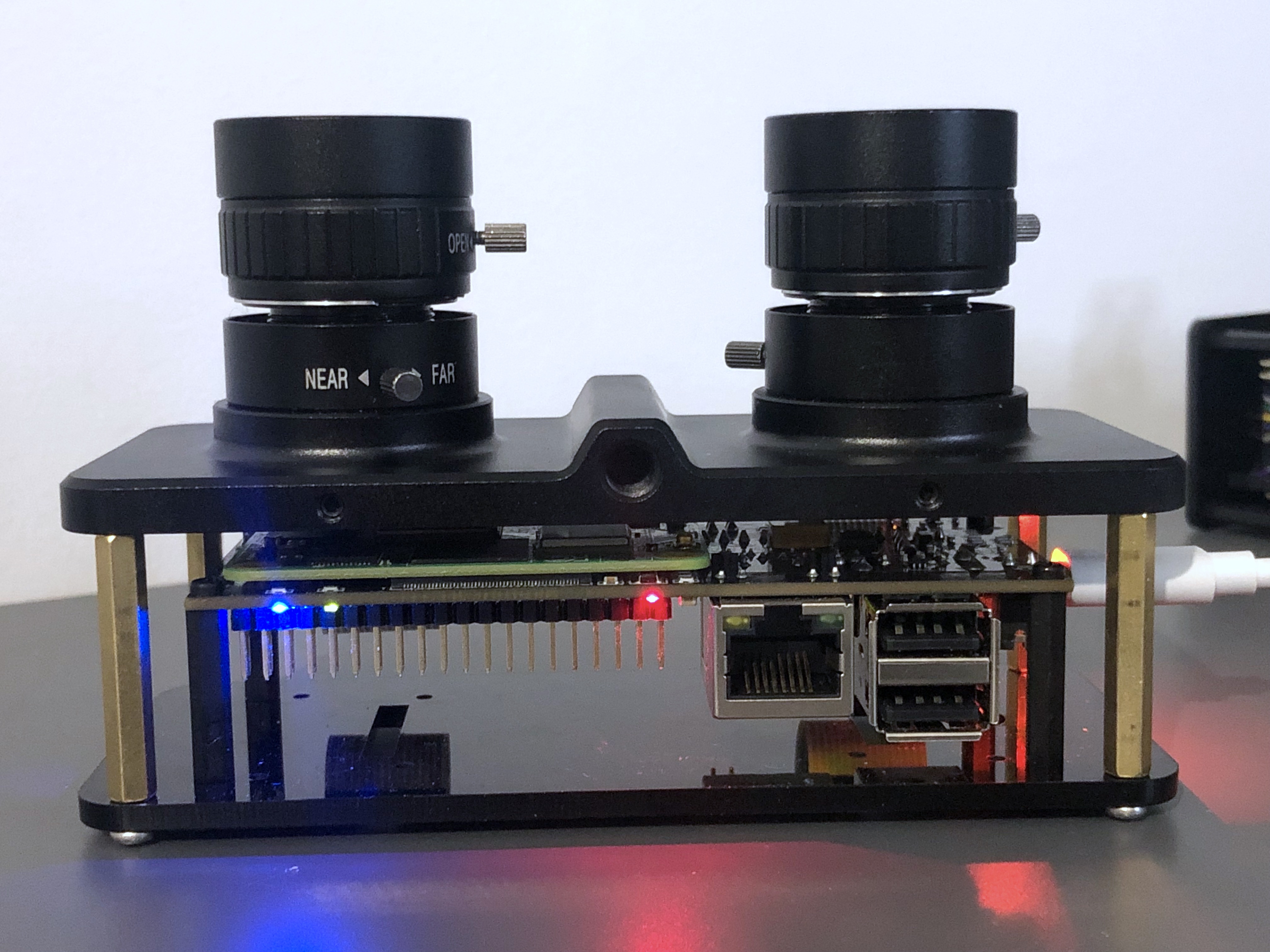

Hi joedevivo,<br>The issue is that the 16mm lens is C-mount, and has a different working distance. You can notice that HQ camera has a special black ring to adjust this distance, and this led to difficult solution with additional components and threads.<br>The easiest solution is to use an appropriate C-CS adaptor ring. As I see on your photo, you are using the 5mm ring provided with the HQ camera or 16mm lens. The ideal ring height for 16mm lens is 7-8mm. If you have no this kind of a ring, you can use <a href="https://www.amazon.com/C-Mount-Adapter-Extension-Security-Cameras/dp/B096FG8X78/ref=sr_1_2?dchild=1&amp;keywords=c-cs%2Badapter%2B2mm&amp;qid=1634677856&amp;sr=8-2&amp;th=1" class="postlink">this kind of set</a> with a few 2mm or 3mm rings to adjust the height of your 5mm ring.<p>Statistics: Posted by <a href="https://forum.stereopi.com/memberlist.php?mode=viewprofile&amp;u=2">Realizator</a> — Tue Oct 19, 2021 9:21 pm</p><hr />

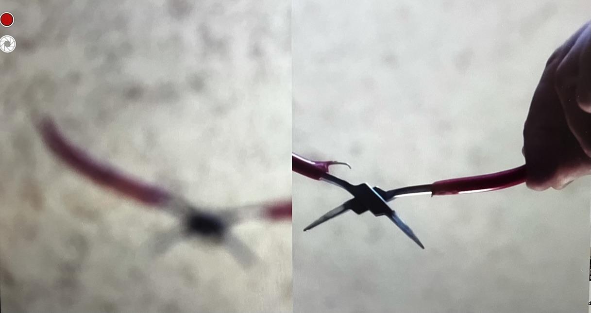

I've finally got everything working but my images are too blurry to do anything with. I'm using two HQ camera modules with two 16mm official raspberry pi telephoto lenses. I am able to get them to focus if I significantly loosen the lenses, but then they're too loose to stay where they are. Any ideas how to fix this. Am I missing some part?<br><div class="inline-attachment"><dl class="file"><dt class="attach-image"><img src="https://forum.stereopi.com/download/file.php?id=235" class="postimage" alt="919553CA-DAD5-48E3-B21B-30567E2AEAFC_1_105_c.jpeg" onclick="viewableArea(this);" /></dt></dl></div><div class="inline-attachment"><dl class="file"><dt class="attach-image"><img src="https://forum.stereopi.com/download/file.php?id=237" class="postimage" alt="D0BD70BC-F906-4244-9EA6-1B7BC47D36AE_1_102_a.jpeg" onclick="viewableArea(this);" /></dt></dl></div><div class="inline-attachment"><dl class="file"><dt class="attach-image"><img src="https://forum.stereopi.com/download/file.php?id=236" class="postimage" alt="6F74D4D0-1FFB-4DC5-8366-89130B31553D_1_105_c.jpeg" onclick="viewableArea(this);" /></dt></dl></div><p>Statistics: Posted by <a href="https://forum.stereopi.com/memberlist.php?mode=viewprofile&amp;u=997">joedevivo</a> — Tue Oct 12, 2021 3:05 pm</p><hr />
