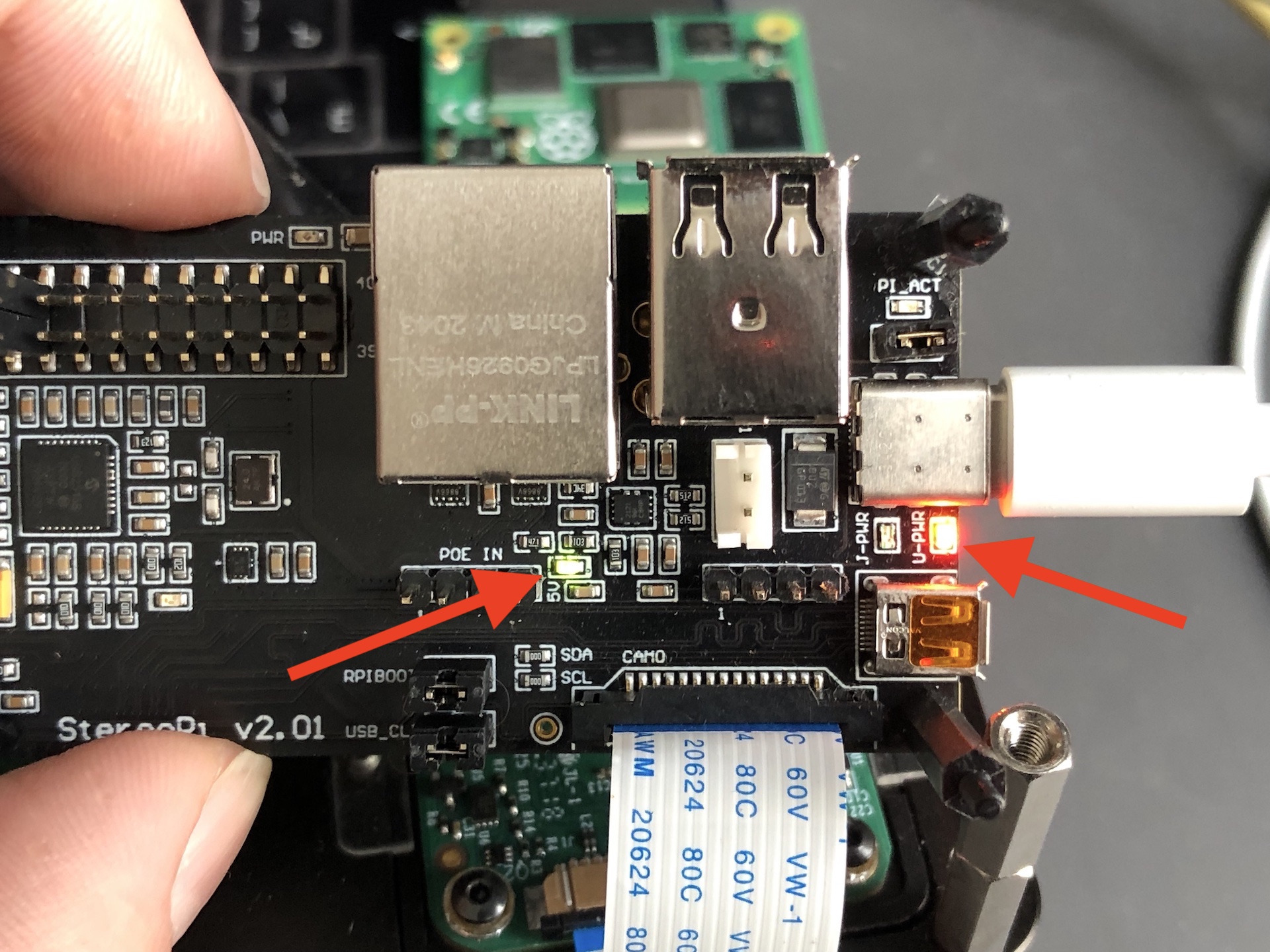

Hi Cytan,<br>I'm using Mac too. You are right - for the eMMC upload you need to use the USB C cable only.<br><br>Let's check two things:<br>1. When you connect the USB C cable <strong class="text-strong">without the compute module attached</strong>, two LEDs on your StereoPi v2 should light up:<br><br><div class="inline-attachment"><dl class="file"><dt class="attach-image"><img src="https://forum.stereopi.com/download/file.php?id=226" class="postimage" alt="no-cm4-noted.jpg" onclick="viewableArea(this);" /></dt></dl></div><br>If you see only one LED (U-PWR near the USB C port), it means the board "feels" the power, but is not turned on. Please check your "switch" jumper is inserted (near the PI_ACT LED).<br><br>2. When you connect the USB C with CM4 inserted you should see one more active LED, which is "PWR". This means your board is powered on now and will either boot (if no RPIBOOT and USB_CLI jumpers attached), or go to the "mass-storage" mode for the eMMC upload.<br>Here is the photo of the board with all LEDs active:<br><br><div class="inline-attachment">The attachment <strong>with-cm4-noted.jpg</strong> is no longer available</div><dl class="file"><dt class="attach-image"><img src="https://forum.stereopi.com/download/file.php?id=227" class="postimage" alt="with_cm4_noted.jpg" onclick="viewableArea(this);" /></dt></dl><p>Statistics: Posted by <a href="https://forum.stereopi.com/memberlist.php?mode=viewprofile&amp;u=2">Realizator</a> — Wed Sep 22, 2021 10:34 am</p><hr />

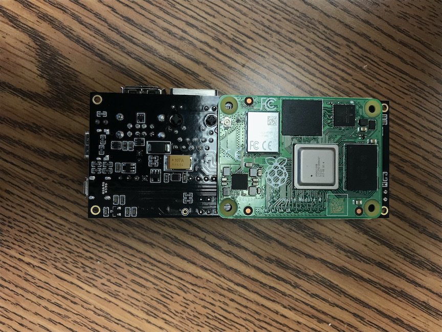

Hi Relizator,<br>   I've shorted out both the RPIBOOT and USB_CLI and still no joy.<br><br>   I was expecting to see under USB devices the existence of a Broadcom device, but I see nothing in the USB3.0 tree in either the Mac or the PC.<br><br>   My Mac running Big Sur 11.6 and Win10.<br><br>   I understand that I will need to run rpiboot to get the disk recognized. But I think it's not going to work unless my computer (Mac or PC) sees the Broadcom device.<br><br>  Just in case I inserted in the RP incorrectly, here's a photo of it:<br><div class="inline-attachment"><dl class="file"><dt class="attach-image"><img src="https://forum.stereopi.com/download/file.php?id=225" class="postimage" alt="IMG_2006.jpeg" onclick="viewableArea(this);" /></dt></dl></div>  And I'm connecting a USB C cable only for this test. Does this test work with a USB C cable only?<br><br><br>cytan<p>Statistics: Posted by <a href="https://forum.stereopi.com/memberlist.php?mode=viewprofile&amp;u=982">cytan299</a> — Tue Sep 21, 2021 4:53 pm</p><hr />
