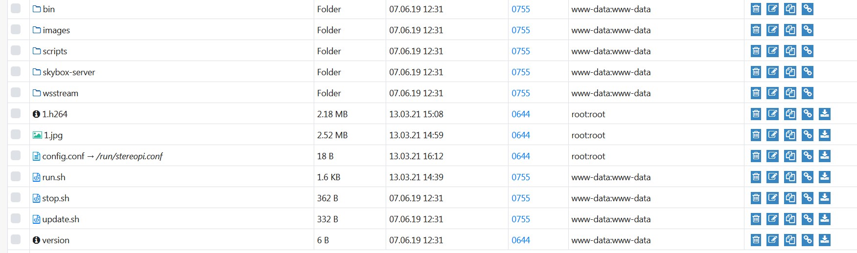

My SLP updated image works well exept config.conf which needs 755 or 777 rights.<br>I`m trying to find how to change rights on boot or what change it back to 644. All other files in the same dir have 755.<p>Statistics: Posted by <a href="https://forum.stereopi.com/memberlist.php?mode=viewprofile&amp;u=60">zoldaten</a> — Mon Mar 22, 2021 6:10 am</p><hr />

You are working against the way SLP works (which is not a reproach, you do what you want with your board) so you have to find which mechanism you did not brake that is doing that. The mode is classically changed by a chmod or a copy, or sometimes if a file is removed and rewritten. I let you investigate.<br><br>By the way, using 777 mode is usually a good alert signal that something is done wrong.<br>For example here, one could wonder why you need execution rights on a configuration file.<p>Statistics: Posted by <a href="https://forum.stereopi.com/memberlist.php?mode=viewprofile&amp;u=101">stereomaton</a> — Sun Mar 21, 2021 9:52 am</p><hr />

But after reboot /opt/Stereopi/config.conf again with 644 rights (<br>How to fix that to 777 to make it automatic ?<p>Statistics: Posted by <a href="https://forum.stereopi.com/memberlist.php?mode=viewprofile&amp;u=60">zoldaten</a> — Thu Mar 18, 2021 12:34 pm</p><hr />

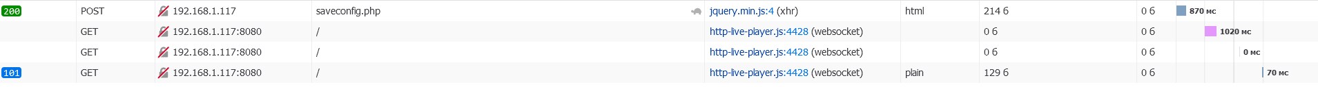

Ok. Got it worked! (but web-interface buttons still dont((  )<br><br>Firstly, i think just to <div class="codebox"><p>Code: </p><pre><code>rpi-update</code></pre></div>, but remembered my wi-fi dongle was build in current configuration.<br>So. I put <div class="codebox"><p>Code: </p><pre><code>sudo vcdbg set awb_mode 0</code></pre></div> to /opt/Stereopi/run.sh as 2d string.<br>After that <div class="codebox"><p>Code: </p><pre><code>raspistill -3d sbs -o 1.jpg</code></pre></div> become possible.<br>But still werent no video streams.<br><br>So i found out if use /opt/Stereopi/stop.sh - makung photo on browser is possible also u can move on directory to see them. But it comes <br>imposible again if manually start again run.sh.<br>Secondly, searching around i learned that if just correct manually /boot/sterepi.conf (not /opt/Stereopi/config.conf) everything works like <br>a charm! (exept making photo on page).<br>At last i just correct /boot/sterepi.conf (previosly remounted boot - <div class="codebox"><p>Code: </p><pre><code>sudo mount -o remount,rw /boot</code></pre></div>):<div class="codebox"><p>Code: </p><pre><code>udp_clients=192.168.1.108:3000 #my pc address i stream udp to udp_enabled=1ws_enabled=1 #to start up browser video</code></pre></div>So. The last steps are - find out how to start working buttons of photo and change options as that still not working. I think the reason of rights.<br>Could you share what rights dirs have, mine:<div class="inline-attachment"><dl class="file"><dt class="attach-image"><img src="https://forum.stereopi.com/download/file.php?id=170" class="postimage" alt="2021-03-13_19h41_35.jpg" onclick="viewableArea(this);" /></dt></dl></div><p>Statistics: Posted by <a href="https://forum.stereopi.com/memberlist.php?mode=viewprofile&amp;u=60">zoldaten</a> — Sat Mar 13, 2021 4:44 pm</p><hr />

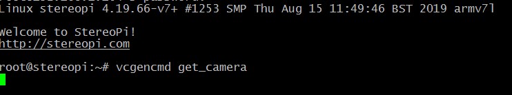

Wow. I never faced the stuck of 'vcgencmd get_camera'.<br>More than a year ago, there was a bug in Raspbian. They updated AWB algo, and this broken stereoscopic support (our <a href="https://www.crowdsupply.com/virt2real/stereopi/updates/raspbian-buster-with-opencv-for-your-stereopi-and-kicad-schematic" class="postlink">post about this</a>, and the <a href="https://github.com/raspberrypi/firmware/issues/1253" class="postlink">GitHub discussion</a> with the Raspberry engineer). Right now, this bug is fixed in the latest kernels, but on your screenshot, I see 4.19.66 - it is the affected version.<br>Please try to run "sudo vcdbg set awb_mode 0" BEFORE accessing the camera. For SLP, it is better to add this row to autostart (or to our run.sh).<p>Statistics: Posted by <a href="https://forum.stereopi.com/memberlist.php?mode=viewprofile&amp;u=2">Realizator</a> — Fri Mar 12, 2021 10:13 pm</p><hr />
]]></content>

1.<div class="codebox"><p>Code: </p><pre><code>vcgencmd get_camera</code></pre></div>gives nothing with two cameras connected:<div class="inline-attachment"><dl class="file"><dt class="attach-image"><img src="https://forum.stereopi.com/download/file.php?id=169" class="postimage" alt="2021-03-13_00h29_42.jpg" onclick="viewableArea(this);" /></dt></dl></div>And freezes SSH-session.<br>2. <div class="codebox"><p>Code: </p><pre><code>raspistill -cs 0 -o test.jpg</code></pre></div> gives the same result.<br>*Ofcause, i remember of rw protection on partition.<br><br>But!<br>If i disconnect one of cameras and reboot. Everything works - i mean commands above gives something like supported=2 detected=1 and raspistill <br>makes photo when call it.<br><br>So. I suppose the problem is in the scripts started on boot that linked somehow with cameras.<br>I tried also with no result:<br>1.<br>- put more GPU memory on boot - sudo nano boot/config.txt: <br>GPU_MEM_512=448<br>- put less GPU memory on boot - sudo nano boot/config.txt: <br>GPU_MEM=128<br>2.<br>manually stop scripts in /opt/Stereopi:<br>./stop.sh<br>But camera led was still light.<br>3.<br>change camera(cameras) and cable(cables).<p>Statistics: Posted by <a href="https://forum.stereopi.com/memberlist.php?mode=viewprofile&amp;u=60">zoldaten</a> — Fri Mar 12, 2021 9:50 pm</p><hr />
