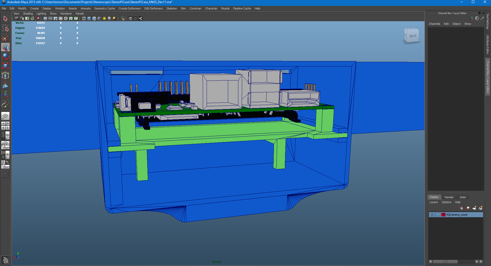

I've attached a few images of the modular case design. The High Quality camera attachment is a work in progress and isn't particularly a priority right now, but most of the work for the typical Raspberry Pi type cameras is done
I've uploaded a few images. I still need to bevel the top edges so they're better to hold whilst holding the camera. Let me know what you think!
EDIT: I tried uploading more but I could only upload three, odd!
No problem, hope they are useful for you and for all tinkerers!
Ah ok cool, what kind of advice can you offer? I'd ideally like a physical button somewhere on my case design that I can press to take a photo.
- Mk03_Dev11a_StereoPiSlot.png (96.8 KiB) Viewed 26258 times
- Mk03_Dev11a_StereoPiInterior.png (97.11 KiB) Viewed 26258 times
- Mk03_Dev11a_PowerInterior.png (124.92 KiB) Viewed 26258 times
- Mk03_Dev11a_ModularWing.png (84.99 KiB) Viewed 26258 times
- Mk03_Dev11a_FullShot_BackScreen.png (85.9 KiB) Viewed 26258 times
- Mk03_Dev11a_AssembledInterior.png (111.72 KiB) Viewed 26258 times
- Mk03_Dev11a_FullShot.png (94.61 KiB) Viewed 26313 times
- Mk03_Dev11a_CameraAssemblyBack.png (105.36 KiB) Viewed 26313 times
- Mk03_Dev11a_AssembledInterior.png (111.72 KiB) Viewed 26313 times

Yeah, the idea is that you can attach/detach any number of 'wings' using the green pegs as shown in the images. Each wing has two carry slots for the pegs, and two fit pegs slots. The carry slots allow the pegs to be more hidden when not in use, whereas the fit slots allow wings to be attached to the main camera body or more wings. Technically you could just keep on attaching wings, although it would get tricky to hold and balance after a while. I think there are camera ribbon cables four metres long, so you could have a stereobase of eight metres

Yeah I'll be using a screen, a Waveshare 2 inch screen, the form factor is nice and slim and it can be connected to the GPIO! Can you use a mobile device's screen as a viewfinder? Even if there is no wifi or mobile data? I'm thinking about using this out and about away from home.
I have uploaded more images!

Yeah, the baseline is adjustable, and the part where the StereoPi sits can be taken out for easy adjustments. The StereoPi slot also helps hold the battery in place. Still needs some work doing to make it better for use and to make sure the camera boxes stay in place properly. I may create a new type of wing or front, as I'm not sure the snap connector I've created will be sturdy enough.stereomaton wrote: ↑Tue Jun 09, 2020 1:57 pmIt looks nice with apparently a compartment for a battery and adjustable baseline.
